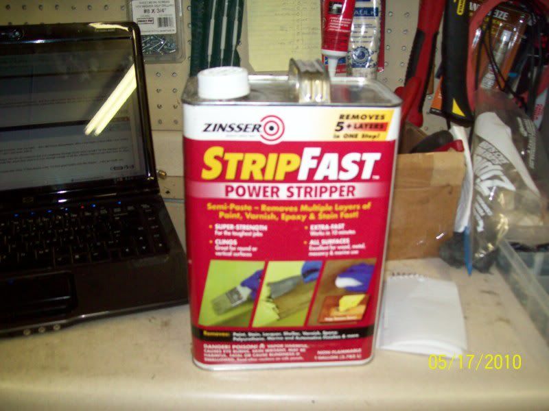

Quit fucking around with the heat gun and razor blade Jon, go to home depot or lowes and get yourself a gallon of liquid/paste power stripper (not that citrus Strip crap either) that eats through several layers of paint. Brush it on liberally and walk away for 15 minutes. Come back with a putty knife and watch your art peel off like a rubber band.

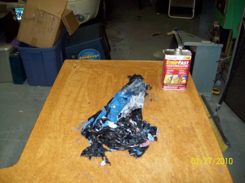

Apparently i was talking out of my ass in my earlier post. Get yourself some of this stuff Jon and quit dicking around with the earth friendly shit. If you see a skull and crossbones, you have the right stuff.
Your art should look like this in about 15-20 minutes and trust me, there was no hot knife, heat gun or wishful thinking that would even touch it without pulling large chunks of wood.
