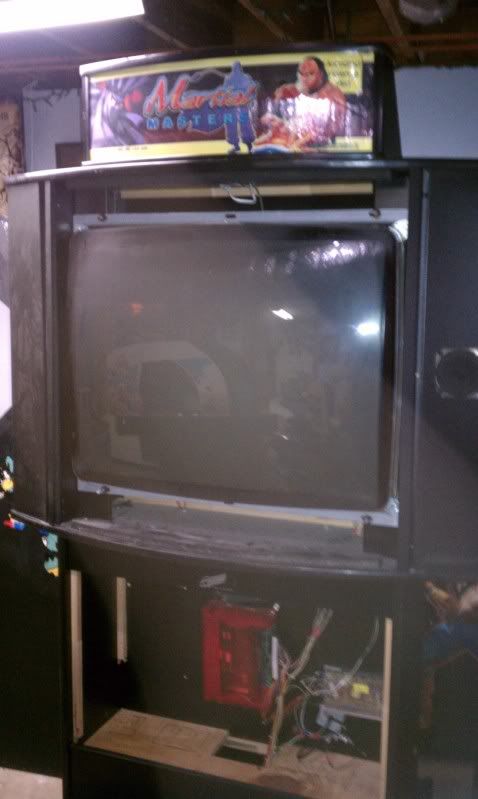

So I picked up a Dynamo showcase cab today, scored it for 35 bucks cause the monitor was dead. It has a game in it called martial masters, which has a normal jamma connection to it. I had an idea to sit a 25 inch monitor from a simpsons cab in it until I can get the bigger monitor diagnosed and fixed, but when I try to run a game through the 25 using the dynamo cab and wiring, the picture is all distorted. This is probably an easy to answer question, but I have no idea what the deal is. Any help would be greatly appreciated!

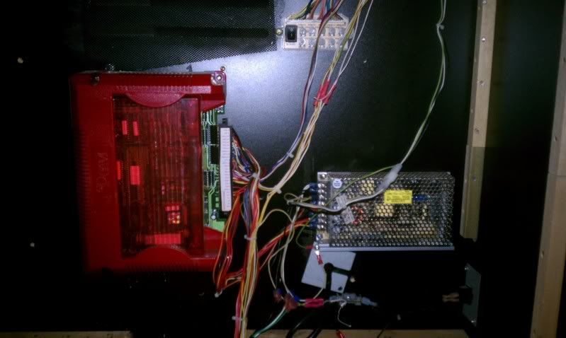

Is the monitor medium res? It may also have a different sync setting (positive or negative). Any pics?
I guess what Im confused about the most, is that I ran the monitor video cable directly to the other monitor and got the distortion. I would assume if its a standard jamma connection, that the monitor would work. But again, I really cant be sure..
According to the KLOV database, Martial Masters is a VGA resolution game. The Simpsons is a standard resolution game. Do you have any other Jamma boards you can put in there to try with your 25" monitor?
-Ian
what's the possibility that the sync pins are different? for whatever reason I can run my Williams/Midway shit on either positive or negative sync on Wells monitors, but maybe that Konami stuff can only do one or the other.
I would think that Martial Masters would have a resolution change option. what is that, Atomiswave or what?
