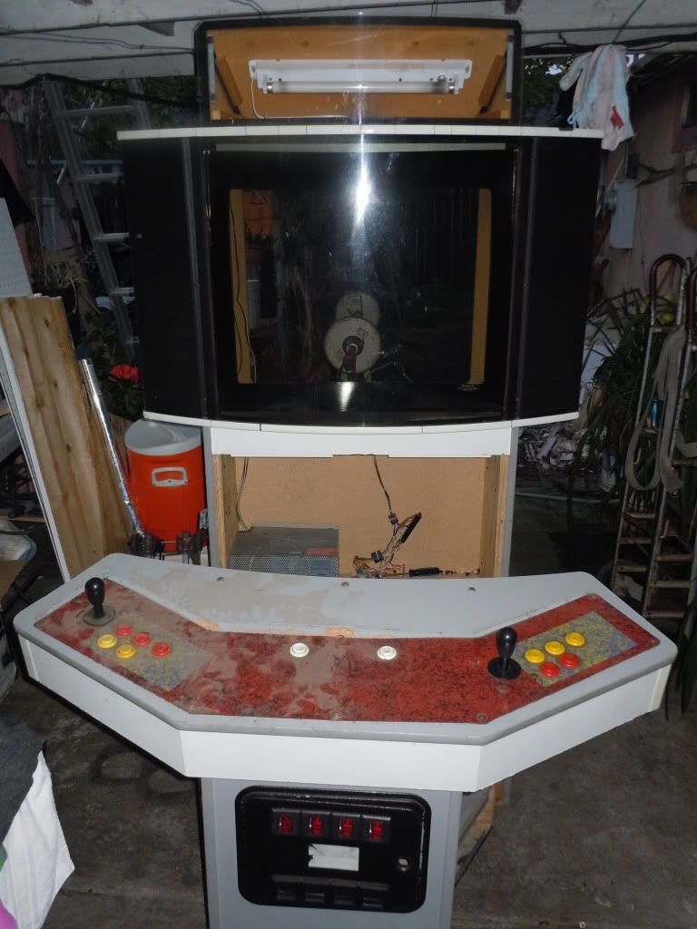

Dont know if you can call this a restore since the game before was a Tekken TAG, but im sure as hell bringing it back from the dead and to proper use...bought the cab empty from pindork1 (cool guy) along with a q-sound big blue.
Now when i first saw them i said "what the hell is up with the control panel! it looks weird!"

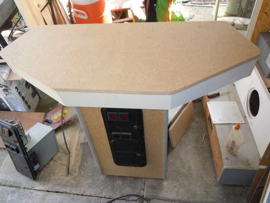

ive never seen a control panel like that on these showcase cabs, so its going to be a tough one making it into a 2 player 6 button control panel...so here are some pictures of the cab itself...
Before and after pictures...
and this is my work area, roof is very leaky so i have to watch out, we had a nasty rain out of nowhere yesterday but lucky me i was home so i covered them and continued working 5 hours later...
my plans for this machine is to put it out in location as a PS3 Marvel vs Capcom 3 since there is still no arcade hardware for this game and ppl have been asking for it where i work so my boss gave me cash and bought the cab....i plan to install competition style happ buttons and joysticks since customers did not like my sanwa setup on our street fighter 4 cabs. My first idea was to buy a flat 32 sony TV and take it out from the case and somehow mount it on the cab but then my friend said why not a LCD and have it hooked up through HDMI...so we are mounting a 32inch samsung lcd...i hope all this comes out good...
