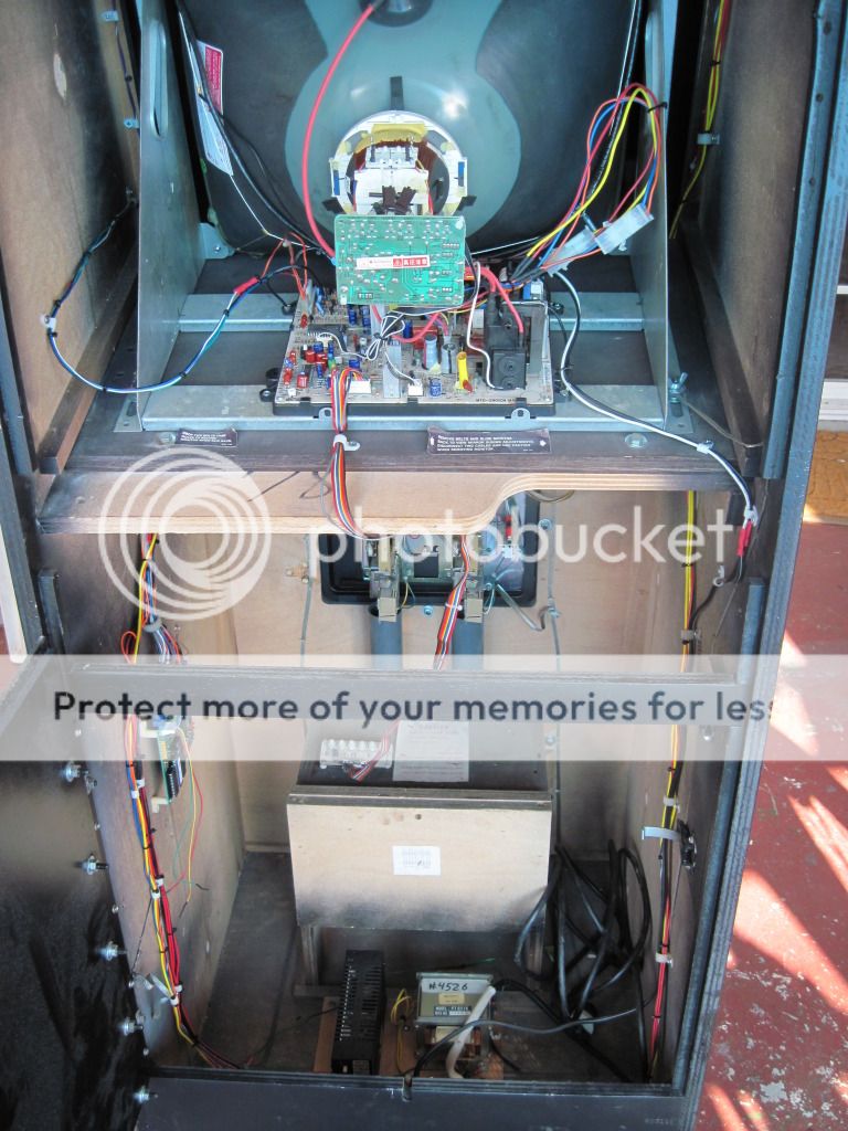

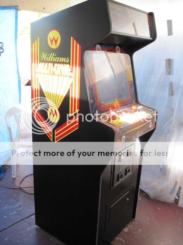

I love my MW! It's a Joust cab running a jrok board with Joust 2 side art colors. Here's my restoration thread on it: http://forums.arcade-museum.com/showthread.php?t=182269
Here are a few pics:

After:
attachment.php
attachment.php
Do you have to hack up the wiring in that joust to mw it?

Tighe, I will remove all of the original boards and wiring and store them. I will have a new CP and CPO made and then run the Jamma wiring and install a switcher.

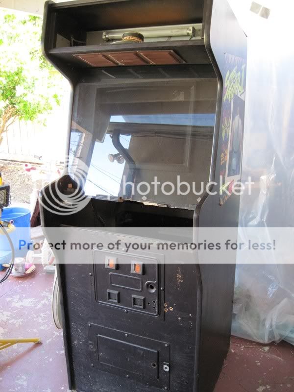

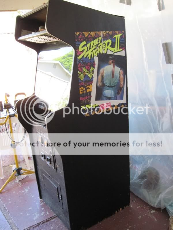

Here is the one I built using an empty Joust cab.
Before:
After:Waiting on T-Molding
I am seriously thinking about repainting it using Joust stencils though.
