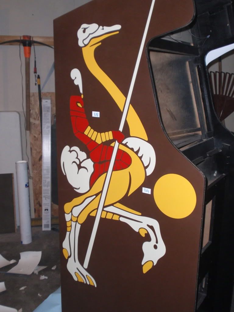

A work in progress...
Mine too. Same cab, different stencil. Hope to finish it up in the next 2 weeks:

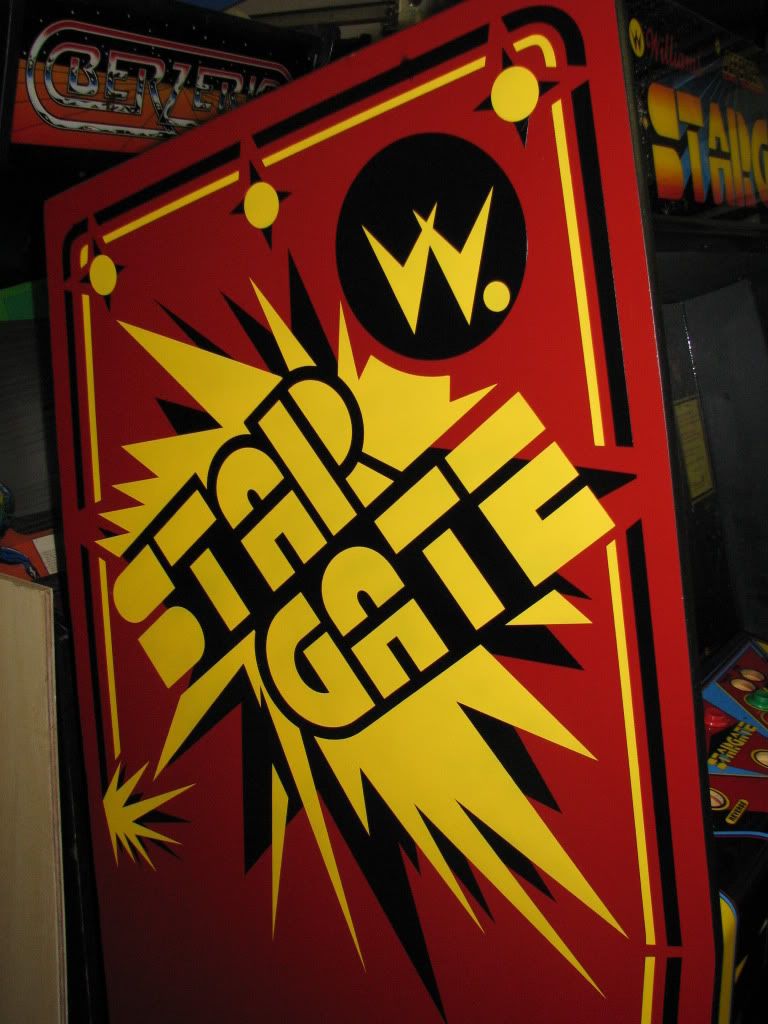

Just finished this Stargate repaint. Gamestencils stencil set, all Rustoleum paints - Regal Red, sprayed from gun, thinned with acetone. Rattle can yellow, then black, sprayed from a gun.

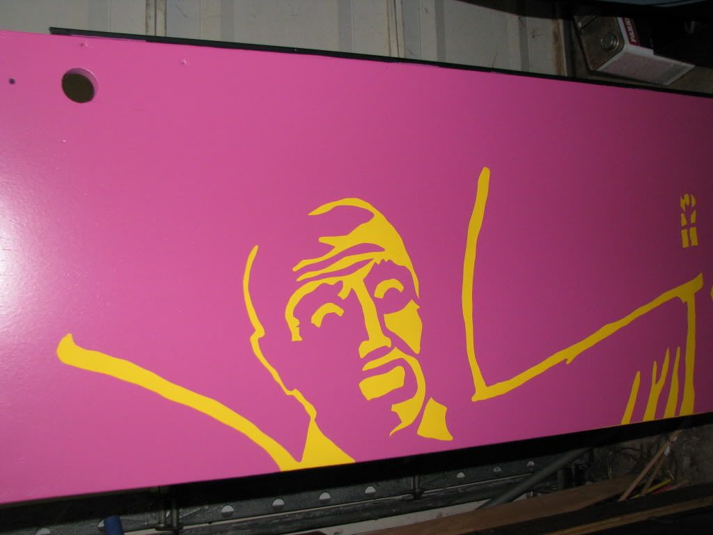

Stern - Dracula. I had this finished, but it's a sand down flat and redo. The water based paint for the base went on wonderfully, but the yellow and black in latex were terrible. I resprayed the base and did the yellow layer, in oil based, this past weekend:
Thanks Phet. The Stargate came out with a hint of orange peel, but so nice that it beats anything I've done thus far. The oil based paint vs the stencil was just flawless. Sharp edges, and I didn't over paint. For the yellow and black - first coat mist coat, not fully covering. 2nd coat, wet coat, still a bit transparent. 3rd, wet, coat - The color was fully filled in. That's it. Let it dry 15 and pull the stencil up.
It made the Dracula look like ass and inspired me to redo the stencil job on it. I've got some other pinball projects that will get repainted, so I want to get it down.
