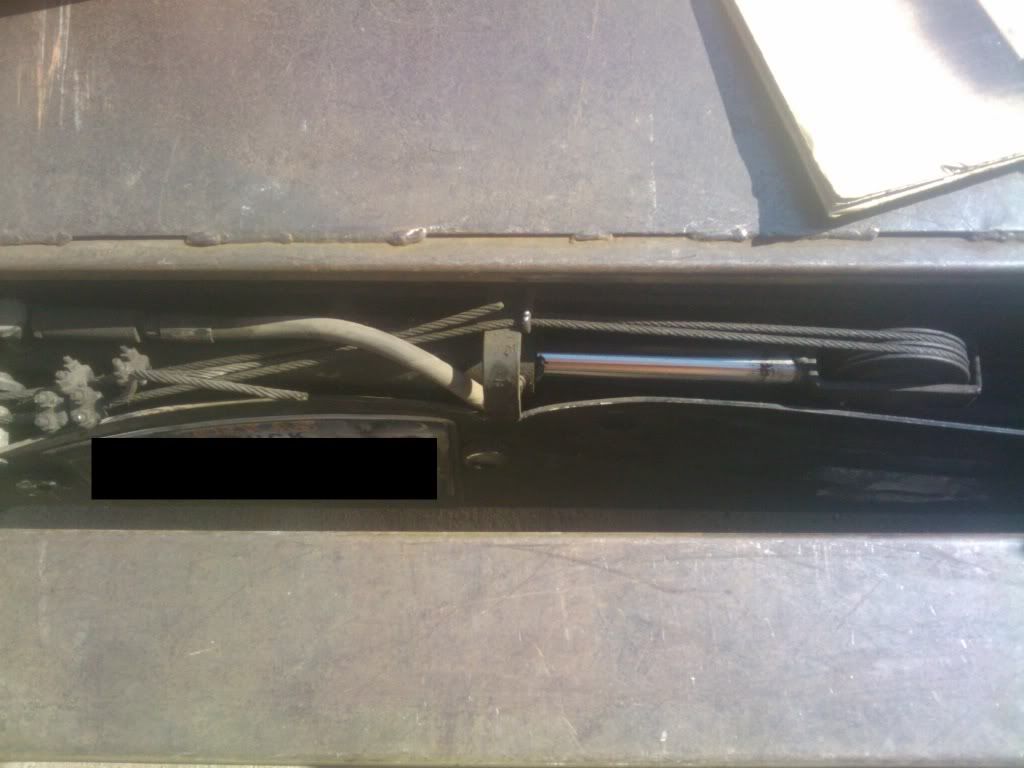

My work truck has an Eagle lift with half-gate extension. Rated for 1000-lbs, but it's lifted more than that. Welded to a flat metal plate in the back of the bed to make it easier to slide games in and out.
Was rear-ended a few weeks ago, and you can see how it bent up the bottom where the hydraulics are. The estimate to replace it is about $3150 - $1895 for a new gate, $500 for a new F-150 bracket, then installation and labor....
