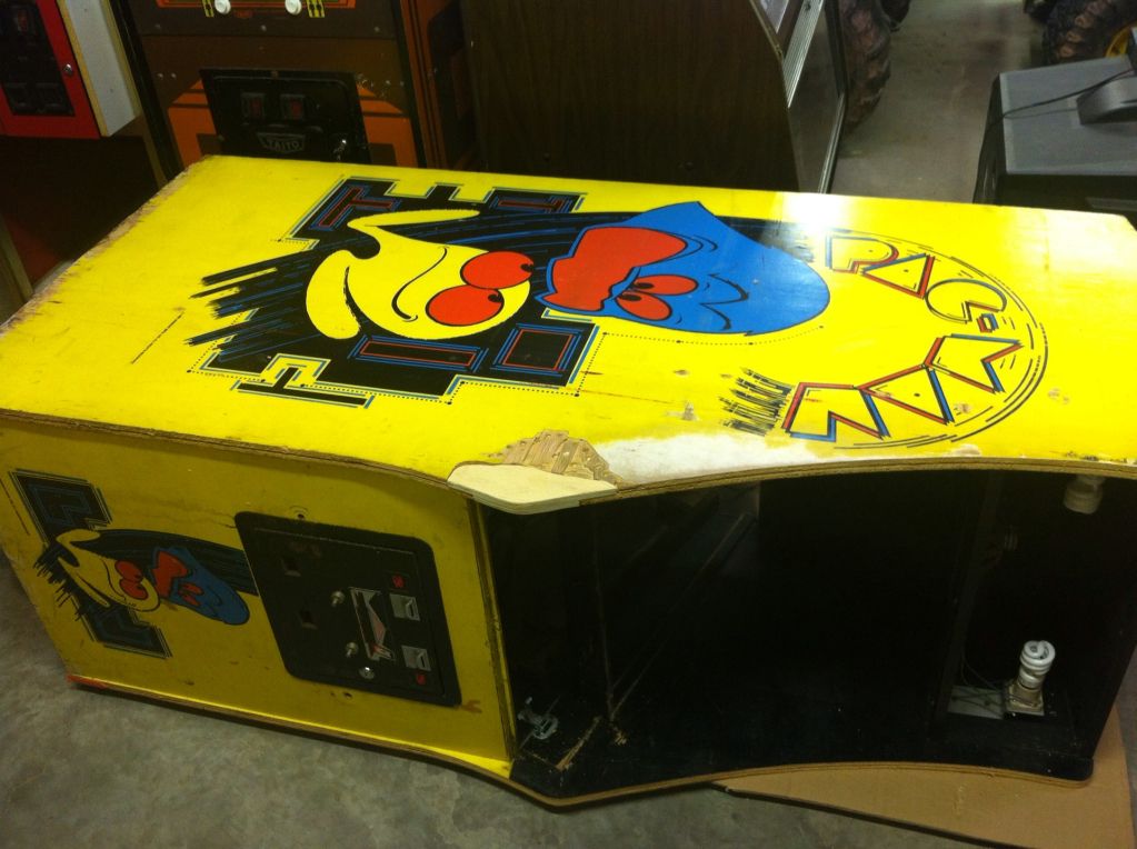

Water damage:
The back panels would be really easy to replace, use plywood!
The top can be sanded using a disc sander, vibrating type, like a buffer.
Once you sand initially, use a good primer, let dry, sand again.
Particle board will come apart, so the primer acts to stabilize, repeat as necessary till your happy.
The top really isn't "seen" so you don't need perfection.
The front can be bondo'd but you will need a t-mold router bit to reinstall the t-molding.
Use screws to add strength, in other words screw drywall screws in leaving them extended so they are within the Bondo when it's finished. Kind of like rebar in concrete. I am doing this same repair on a Pacman, except inserted wood back into the hole. Pacman is plywood though, not sure how a wood patch would work on particle. Don't leave screws out too far that you hit them when cutting the t-mold slot!!!
If the particle is loose or flakey, coat it with wood glue which will soak in a bit it to make it more solid so the Bondo doesn't just pull off. Do the glue after the screws are installed.
Good luck! :D
The PAC repair:
