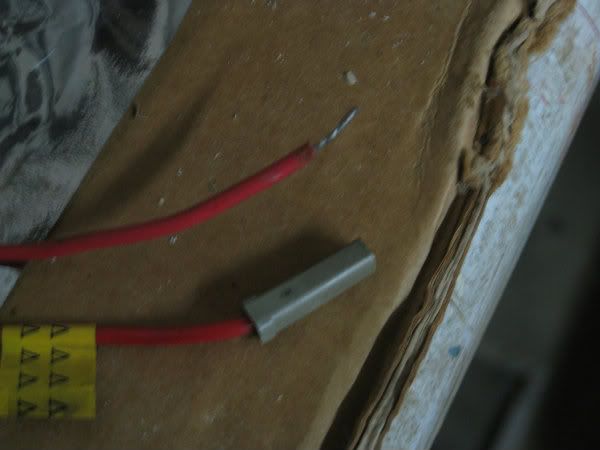

So I'm finally getting around to this today. C207 is mounted on the other side of the board, so mystery solved there. Everything seems pretty straightforward except for the flyback. The original had a pin/connector for the wire that goes to the neckboard (not the one the mounts directly to the socket). The replacement only has a simple wire. I have the connector on the original wire a good tug and it doesn't seem like it will come off easily. What kind of connector is this and can it be found anywhere? If not, what's the typical procedure for this? Remove the pin on the neckboard and solder the wire directly to the board? Butt-splice the old wire with the connector to new wire? Thanks for any pointers.
pics of what you are talking about.
but:
splicing it is fine.

A picture would probably help. It's on the wire that comes out near the 'Screen' control (bottom of flyback). The top wire is from the new flyback, the bottom is the connector on the old one.
Edit: I thought the ground wire(s) was the black wire that's wrapped through the hole in the corner of the neckboard near the neck socket (i.e the wires I have to remove so that I can pull the tabbed part of the socket off to insert the new focus wire). Is that wrong?
no.
put the black wire back on the corner of the neck board.
you can solder that red wire back on the neck or splice it on so you can use the connector.
either way is fine.

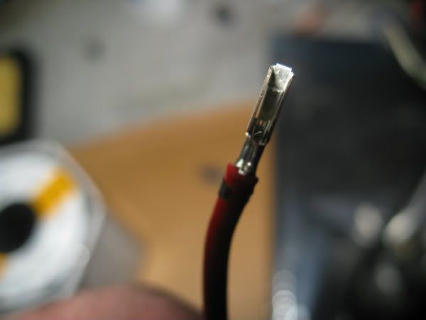

OK, one more thing. I saw a small slot on the end of the connector and using a 1mm flathead I was able to back the wire out and this was on the end. What type of connector is this? Thanks.
