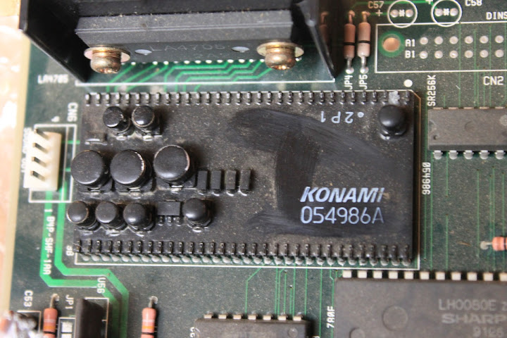

took a look at my Xmen board
The sound works fine on it but I wanted to inspect it for leaks.
Here it is before I touched it.
I tryed to spray some alcohol on it to neutralize any possible leakage that might eat through the traces and then the paint started to come off. I just kept on at it thinking that I wanted to clean it incase I could cap the hybrid board.
I had pulled the needed caps for this one $1 worth.
After cleaning it looked like this. The paint was flaking off so I get the feeling that things are starting to go on my caps.
Anyone's thoughts as to if I should just go ahead and cap this hybrid chip?
My GI Joe looks like it's starting to go also.
I would go ahead and cap it. It's already leaked some and it's not going to get any better. You did the right thing by cleaning it up now while it still works. My 4 player board worked fine for years with no trouble until I took a closer look at it. Last time I had it hooked up to my supergun, I was able to watch the electrolyte leak out from the caps. :(

I'm thinking that taking care of this hybrid chip is as important as watching your Capcom Suicide batteries. It's not as devastating as the suicide but once the hybrid is damaged on the back side, you have dead sound and there is a relatively cheap/straightforward (but ugly) fix for the hybrid.

Both Run and Gun games also use the chip...2 of them in fact. It's the other version that's also used on lethal enforcers.
Since I have two solder irons, I'll use two at once to desolder these surface mount caps.
Yeah I think that everything but Xmen uses the 054986A hybrid chip. I'll see how clean of install I can do. My traces look all clean still. I will test them after I get the caps out of the way.
I just recapped mine today, haven't tested the board yet. When desoldering with two irons, watch out for the old caps popping when they get too hot. All of the 47uF's let out a bunch of smoke from burning electrolyte, so be careful your face isn't too close...

I removed the caps from the hybrid on my Lethal Enforcers last weekend. Awaiting parts shipment before I can install new ones.
I wasn't able to desolder any of the old surface mount caps. I tried, but ended up pulling them off with pliers, then cleaning up the pad with solder wick. But I was using a regular iron, I don't have any equipment intended for surface mount work... In any case, I got everything off without any apparent damage to the underlying substrate.
I'll post pics of before, during, and after when the job is done (and hopefully a success).
Oh, when I was trying to desolder the caps (and burning the plastic bases, and any leaked electrolyte), I swear it smelled like fish...
