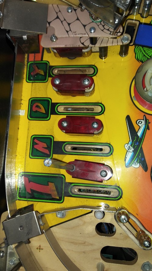

Doing a deep clean then wax, and rubber kit. And trying to figure out why my mini playfield is not tilting like it should.
Mini playfield is removed and working on cleaning before wax.
Before
After
Before
After

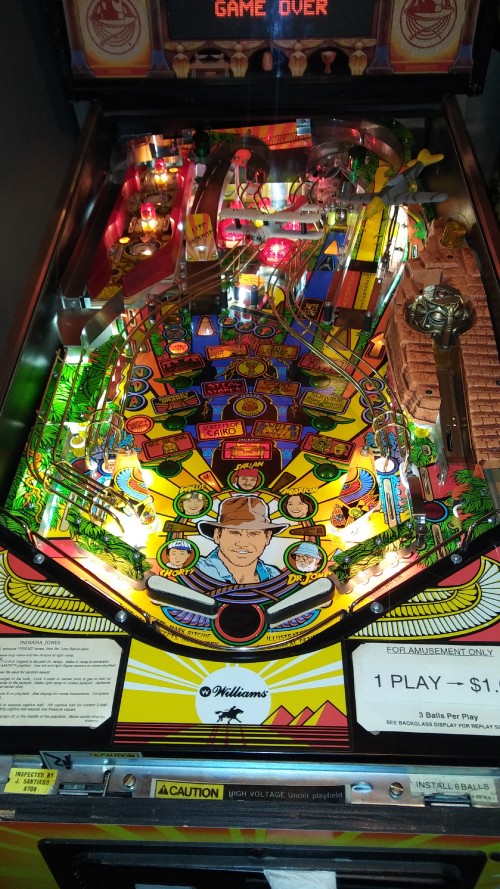

Full rubber kit done. All playfield gi led except trough area
Left flipper adjusted. Playable now.

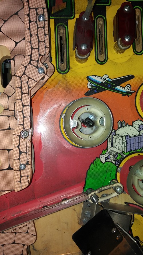

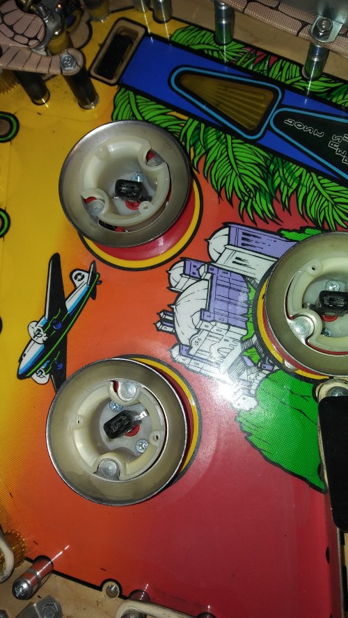

And left pop bumper is nonfunctional... Never was apparently. Ill work on that later.
It looks sooo much better now... Damn near huo quality
Play is soooo fking fast with new rubbers and a wax...

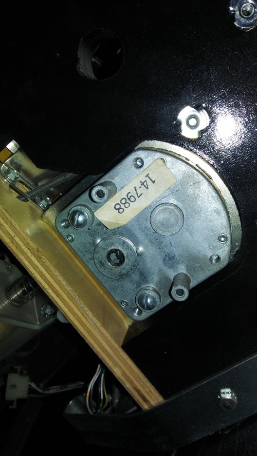

Do you see what I see.... Whats missing....
I will say at around 2pmcst.
It has to do with the mini playfield that is currently not working.
Ok a little late...
But the gearbox for the path of adventure is there... But the darn motor was removed
So yay i get to buy a new one :(
