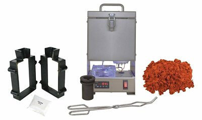

The electric furnace that I originally purchased was listed as "For Sale" on E-bay. He actually did not have it and complained of supply chain issues. I can understand that, but he should not have an actual listing of one "For Sale". After waiting on him, I cancelled that order and purchased this one. I am waiting on the sand that is supposed to be delivered today.
I should have been purchasing AL at all of the garage sales that we go to. Retail AL at the hardware stores is expensive. This stuff from Goodwill is cheaper.

It has been a long day with my furnace. I kept thinking that I was not getting it hot enough. I was blowing through the sand and making an imperfect mold. I finally turned it down and got a decent mold. I went to do a second and found out that my metal was too cold. This set-up sure is finicky.

I have some cleaning up to do. Over all, this casting went well.
