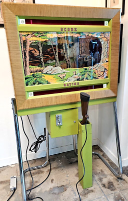

Does anybody know of user "panta71" from Italy on E-bay. He is trying to buy some STB parts from me there. He also sent me this picture of the dog that he has reproduced. It looks very nice.
I am almost done with my 5th game. Those little green targets have been difficult to reproduce with accuracy.
I had the artwork behind the glass reproduced. As well as the inner tree artwork.
Somebody must really like this game. I was contacted by a guy from France through E-bay to purchase this. I was really leery about selling it to him directly. I told him to find a broker to help him out. This morning it sold to a guy from TX. After speaking to the guy from TX, I found out that he bought it for the guy from France. This game will be getting a lot of miles put on it to find its new home.
