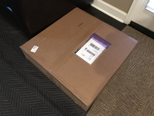

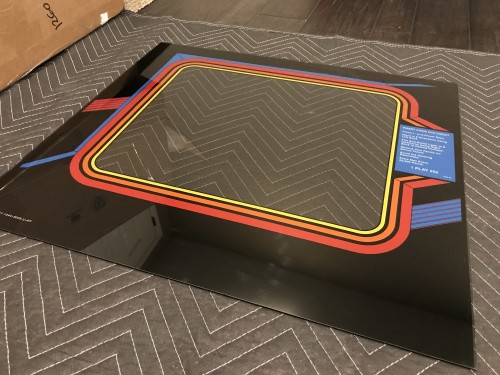

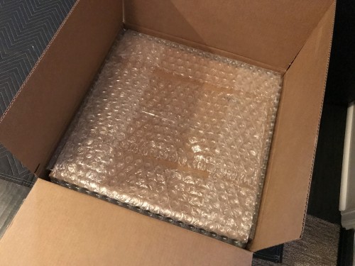

Actually, it just occurred to me that I remembered taking pictures of the Robotron bezel unboxing! Looks like the first layer is bubble wrap. I'd say each box was at least a few inches wider than the box/bezel before it. The outside box was a least 8 inches tall. Hope this gives you a good enough idea. (Photos are shown in order of unboxing)
