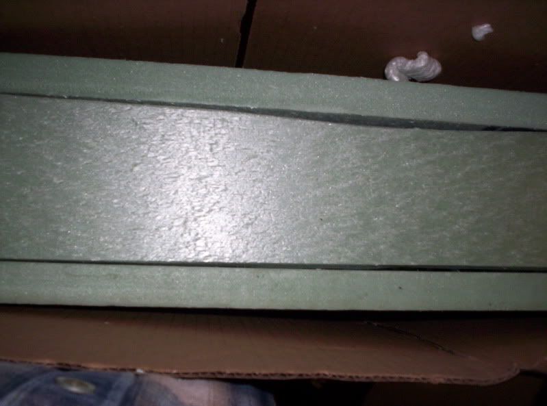

Here is the box with the protective Styrophome installed:

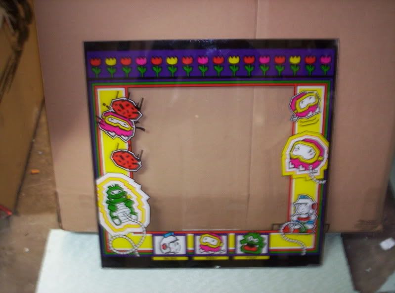

This is the bezel to be shipped. I put a healthy amount of bubble wrap on it for protection.

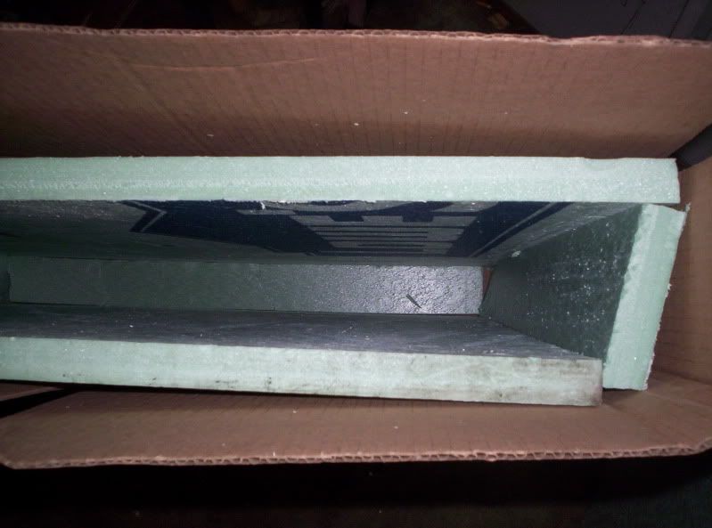

After making the box, putting in the styrophome in and evenly distributing peanutes aroung the bubble wrapped glass:
Last pice of styrophome on top for a cap. Same as piece on bottom and sides:

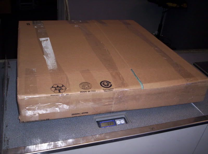

Finally the finished box taped and laying on the FedEx scale:
The total cost for the packing materials was $7.50. To ship this to Portland Oregon Via FedEx ground from Indianapolis, Indiana was $21.00. I think that is a good price considering it it pretty much the furthest point from me in the USA. The total shipping weight was 15.85 lbs.
