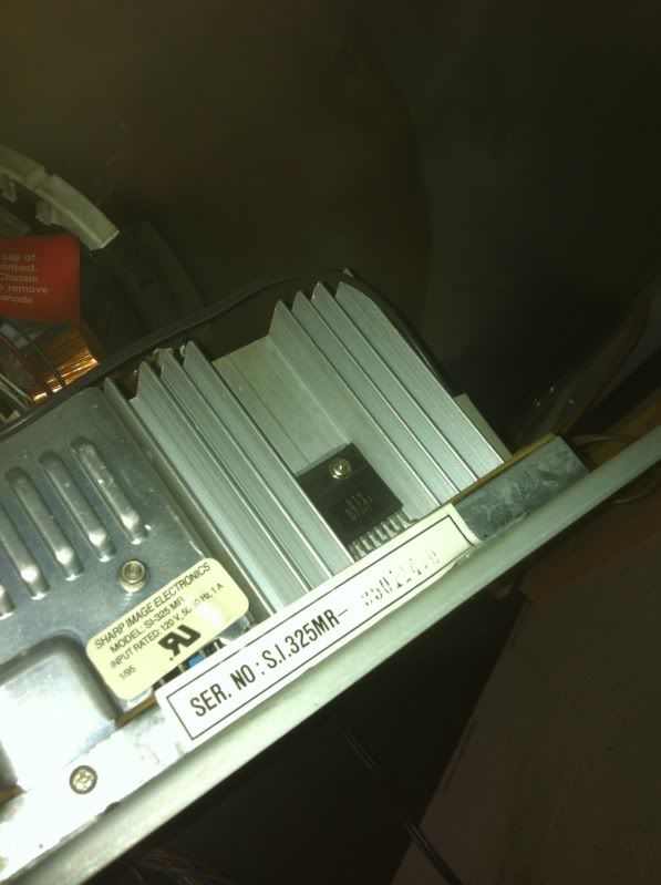

Hi,
I have a arcade machine with a 25" Sharp Image SI-325MR monitor, it's running EGA medium resolution (the game inside the cab is Virtua Striker 2 Ver. 99 Sega Model 3).
Does anyone knows if this monitor also supports CGA 15Khz Standard Resolution (switchable CGA/EGA like Wells Gardner U5000)?
I didn't find a manual for this monitor anywhere.
Found some pictures of the monitor:
Is it a switchable monitor (CGA/EGA)?
If not than would it be possible to convert the chassis to a normal SI-325 CGA 15khz?
Any ideas?

I have the same monitor PCB and its working with my NeoGeo MVS which is CGA 15khz.
I think (key word is think) you can switch between CGA and EGA by moving the yolk socket(is that what its called?), but I do not have any EGA compatible PCB to test.
Someone correct me if I am wrong.
