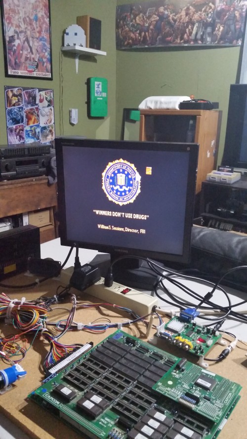

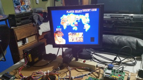

So, I started taking another stab at this, this weekend. I ordered some 27C1001, and burned a complete set, with the intent of swapping roms one by one to find the one that is causing the non-boot.
The new complete set would not bet on either the B board that original had these US Rev D roms, nor on a known good board. Same issue on both. I won't bother fully explaining the symptoms... there was some signs of life but not much.
So, I put the original roms back in, and had noted in my research that the US Rev D roms are associated with the C board containing CPS-B-05. So, I first replaced a missing CCX ceramic capacitor on that board from a parts A board, and then married up B and C board.
I then tried the pair on a soundless A board that I haven't yet gotten around to troubleshooting the sound issues, but is otherwise working.

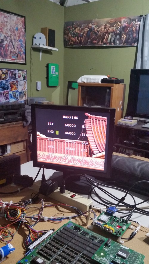

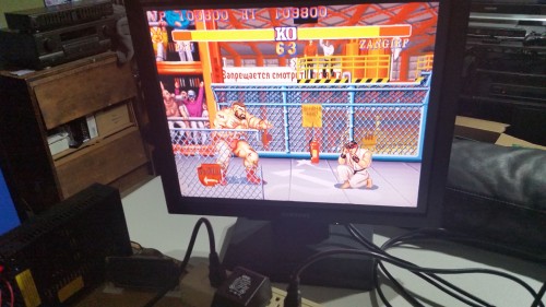

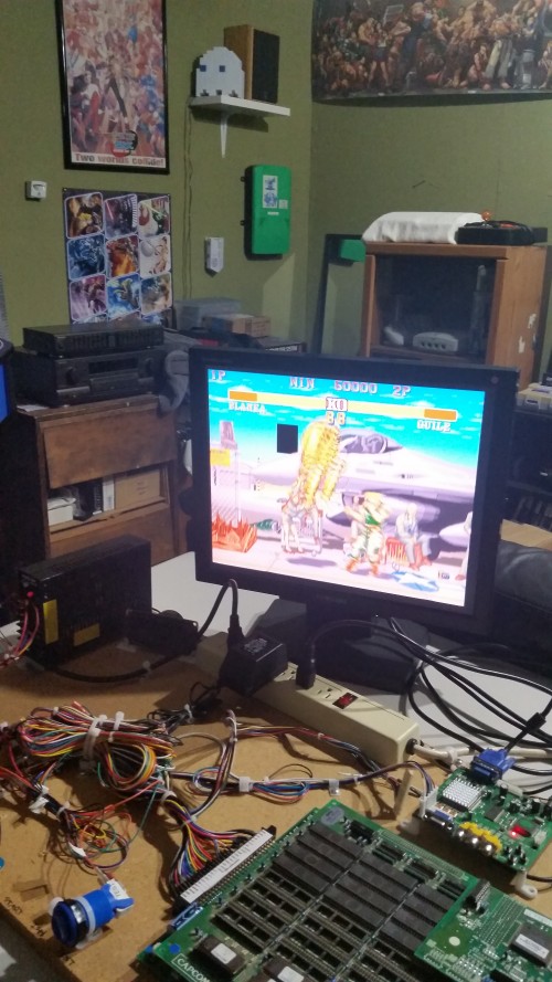

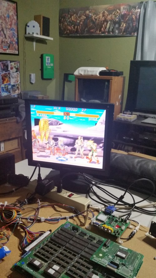

And it came up with 90% success. Some graphics issues, as you will see below.
I then tried the pair on another A board, one I am working through tracking down sound cutting out after 5-10 minutes. And, I got the same result - 90% success with the graphics issues you see below.
I then tried a CPS-B-17 C board, and got a no boot. According to the below link, only a couple of C boards are interchangeable. I suspected that to be true, and that the '17' C board and '5' C board are not interchangeable. My testing seems to support this.
http://www.arcadecollecting.com/info/cps-b_numbers.html
So, with 2 A boards which are presumed 'known good with audio issues' producing the same result (aka it is not a A board custom causing the problem), where to look next?
Anomalies at the fence
Anomaly at the street, at the sidewalk corner. Also, the black blocks which are more obvious.
Anomalies in the roof and the floor.
CPS-B-05 and CPS-B-17 are not interchangeable.Are you using the same B-BOARD?If yes, I'd check the MAKS ROM as well as sockets.Can you use a good known CPS-B-05 in order to rule it out?
^Yes, 2 known good A boards produce the exact same results. If I take them to a known good 910214 B/C set, there are no issues.
Same B board in both cases of issues. I did swap in the 910214 roms on this B board, in conjunction with a B-17, and there weren't issues. Unfortunately, this questionable set is the only rev D roms and B-05 that I have.
Thanks for the suggestions, I will start pulling and checking mask roms...maybe even run the board through the dishwasher. It is pretty dirty, possibly there some funk buildup somewhere causing a short.
