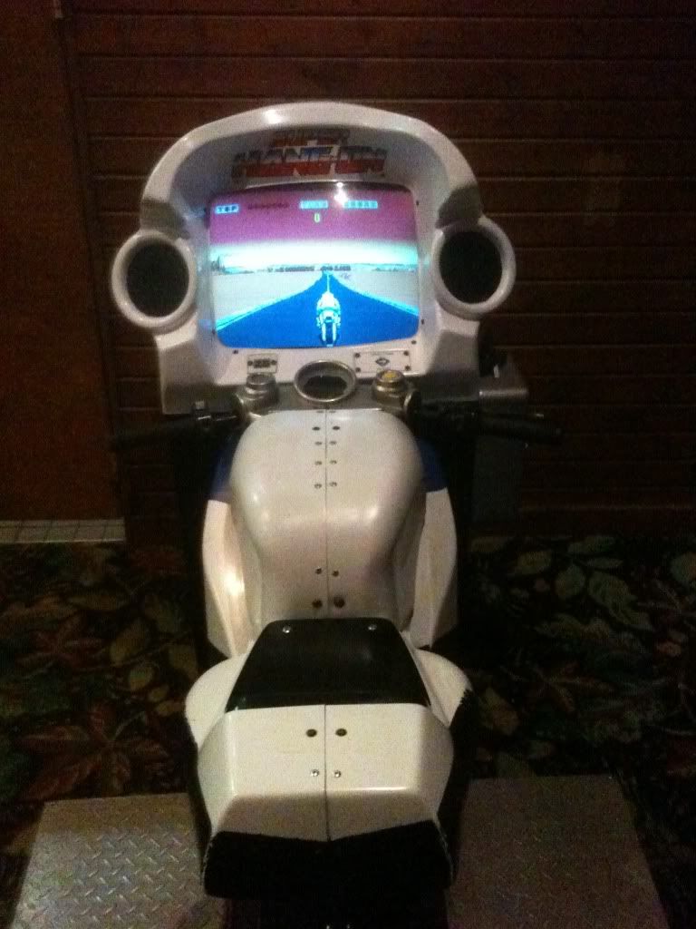

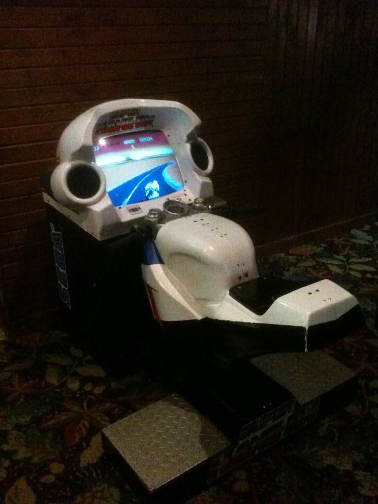

I am dead serious. I played the sit down version that leans right and left. What a blast. Layney sat right up on the gas tank while the old man gave him a ride through an unforgiving race course. Loved it.
Dude, sweet!
Where did you play it at? The sit down version is great, and they are usually cheap. Maybe one day I will be able to upgrade. My one vivid memory of that sit down version was at my 7th birthday part at Chuck E Cheese. My Uncle raced motorcycles for a living, but never played video games. He saw that game and played it my entire party. It was awesome.
