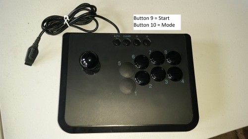

After building myself one, and being hired by a fellow shoryuken.com member to build one, I thought I would put a couple more together, and offer them up. The details:
  • Both sticks are built using the Mayflash case (very solid and sturdy case)
  • The stock stick and buttons were deleted and replaced with new Sanwa parts and new wiring
  • Start and Mode functionality fully integrated
  • Full 6-button and 3-button functionality
  • Official Sega 6-button controller PCB under the hood
  • Play tested for 2 hrs. each, these puppies are solid
  • Rubber feet added upon request, at no extra cost
  • JLF joysticks contain square gates, I will replace with octagonal gate upon request at no extra cost
  • Full disclosure: the mayflash cases are used. They have some "patina". It is strictly superficial. There are no major blemishes, scratches, nicks scuffs, etc. I'm happy to send more pictures upon request.

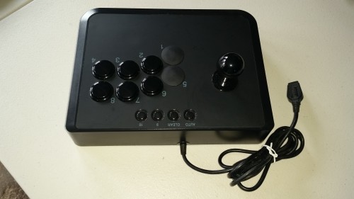

This one we'll call SMOKAY. JLF joystick, Seimitsu LB-39 ball top, OBSC buttons. Fun fact: carriage bolts securing the joystick are from an original Donkey Kong arcade control panel. $120 plus shipping.
****SOLD****This one, I call The Sleeper. I went for preserving the original Mayflash appearance, as much as possible. JLF joystick, Sanwa LB-35 ball top, OBSF buttons. $110 plus shipping. ****SOLD****

The Sleeper is sold. SMOKAY is sold pending payment. If you have interest, PM me, I can build more within about a week on average.
SMOKAY is still available. Just gave it another quick play test, and it is solid. I used my first attempt at building a custom genesis stick, to set the current Twin Galaxies world records in all of the Street Fighter 2 series titles on the genesis. This stick is even more solid than that first edition that I used!
