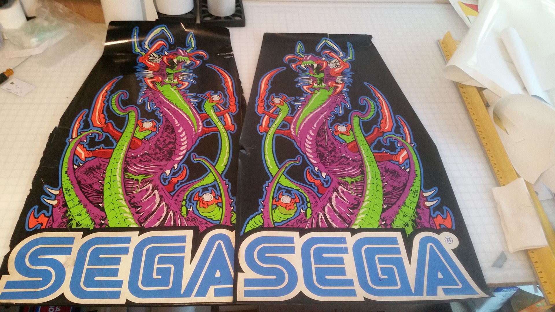

Finished up the rear of the game. Need to cut a new door etc. I have to say a big Thank You! to Fizgig for hooking me up with the side-art and cpo who I think is the only one who has reproduced it. Without him doing it this project would have been dead in the water so Thank You!! P.S. Fizgig originally only had one side to scan and therefore no mirror image. Has since updated the scan file and said he would print a correct mirror image for the other side. Again totally awesome!!! Thanks!!!

Im currently building 3 of these and he isnt the only one with the art. Im currently restoring all pieces. With the recent purchase of the newest epson printer I will be able to print the silver ink for cpo also.
By the way the sideart is completely wrong and everybody that bought it will presumably have the same problem. They should be mirrored with Sega remaining the same. Nice looking work on restoration.
I will since I need a bunch of them. I got it all scanned in as one piece, so it will be the identical per original. It will be a little bit as I just started cutting the cabinets and then art will be done.
