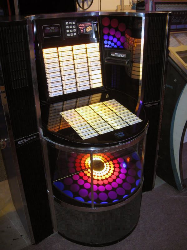

Seeburg SMC1 In The House
Oooooh, Fritz got hisself a present!!
Gorgeous Fritz. Now we can trade 45s!!! I have a huge box full of trade bait. LMK what you want and what you've got on the block when you're ready. R-470 awaits your response:
Nice jukebox, I have the SMC 2 with the spinning disco ball. Be sure to check and or change the batteries in the microcomputer so nothing gets corroded from leaking batteries.
Already done... the batteries looked good but they were replaced anyway.
Anyone done any upgrades to their machines? Freeplay hack? Run a freeplay and/or reject button to the back, etc?
Mine has a reject button in the back. The mcu should have two freeplay settings. No upgrades, but a new pair of needles makes a big difference.

A DS-160 was my first juke! Technically the first coin op machine I ever bought over 20 years ago.
Oddly enough I'm looking at a SMC-2 right now; it's total disco cheese! I think it would be hilarious to load it full of pure 70's disco, and nothing else but disco.
The SMC-2 ups the ante on Disco cheese with that super cool disco ball.
Not sure why the "Disco" model didn't have one but the "Phoenix" model did?
Also... can anyone tell me if this machine is SUPPOSED to play 33.3 records?
It accepts them (small hole) but plays them at 45RPM.\
Also Mike... how did that DS160 sound?
The DS160 was really nice, of course we were newly married, broke as hell, and living in a tiny duplex, so it sat in the corner of the kitchen. Not exactly an amphitheater, but great tone and range nonetheless. I think the Seeburgs from that era in general sound nice.
