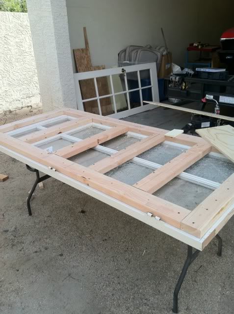

Well, after a few drinks sometime last summer, I decided to make those French doors more interesting. I finally got the ball rolling a few weeks ago with a lot of help from the old man (I can't give my dad enough credit. He's largely the brains behind this project). Step one was to reverse and somewhat recess the door hinges so that the doors swing outward rather than inward (this also required the left and right doors to get swapped), and hang flush with the door frame to help sell the illusion that my future book case is sitting up against a wall. We re-hung the doors to ensure that it worked. Check.
Step two was to build book cases onto the original doors:
I still have to do a lot of sanding, create the backs of the book cases (the glass will of course be removed), add molding, and stain them- but here they are as of last weekend:

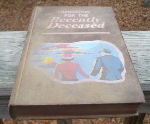

The plan for today was to create the "pull a book to open the door" mechanism.
What book shall it be? It has to be something cool... like Frankenstein, Dracula, or something related to a movie that I dig. I settled on this book, which I got on ebay last week for $10:

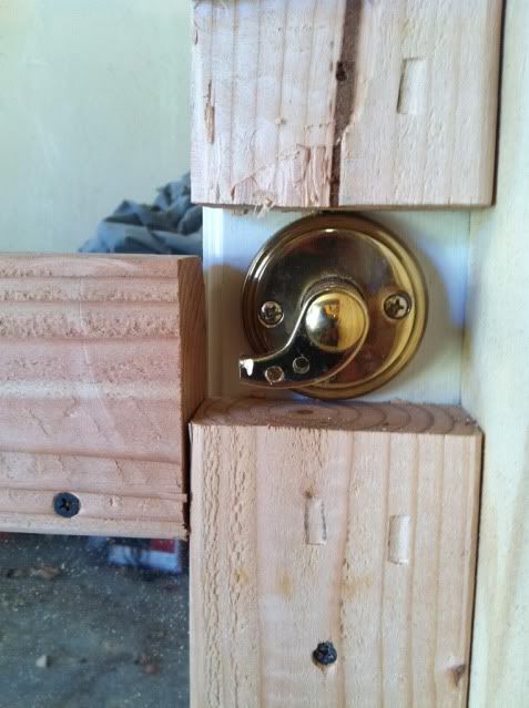

Unfortunately, creating the mechanism has been postponed until next weekend. I hit up like 5 different hardware/hobby shops today, but no one seems to have the clevis that I need (I need 2). I wound up ordering 4 from NAPA to be safe, and they should have them in stock tomorrow.
In the meantime, I hacked off part of the original door handle and drilled a couple of holes in it so that I can put it all together next week:
