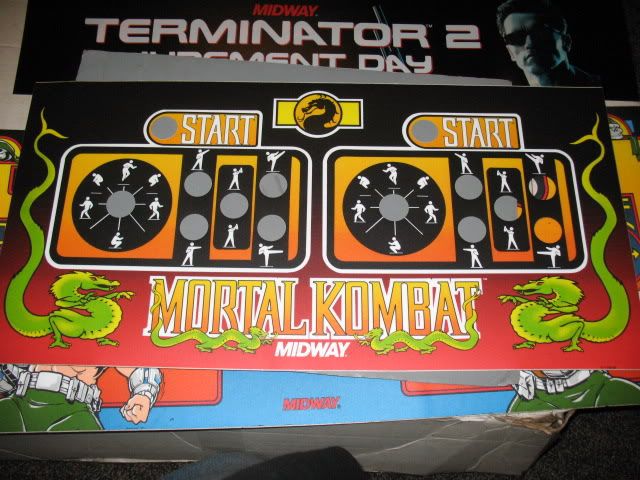

Edit: Here's a pic of the NOS cpo I'm buying. It will be the alternate version with the "stick men" instead of script. From what I've read on the forum, this may be the early version of the cpo and Midway changed it to just script later on. I figure for a NOS piece the price was right and it's a minor detail since I know how to play the game already. ;) Actually it will be kind of cool if indeed this was an early version of the cpo. I can see why they changed it too.

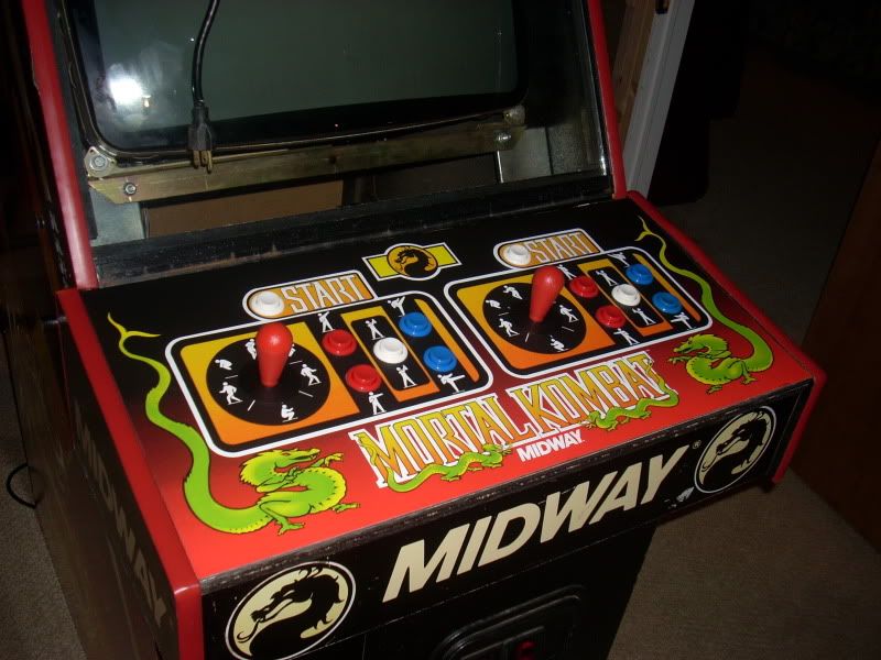

Hmm well this has turned into a bit of a mini restore thread I suppose. Definitely not as involved as my Q*Bert or Simpsons, but still neat because the art was saved. Anyway, I ordered myself some xmas gifts for the MK last week and yesterday it arrived. I received my t-molding from t-molding.com (also ordered some for Q*Bert but that's another thread/story ;)) as well as new joysticks and buttons from Lizard Lick. They have some great prices on joysticks and I went with red Happ Competition sticks and buttons. Unfortunately, they only had 3 blue buttons left in stock so I ended up one short, but I have a spare on hand. If it feels too out of place when I install it I'll replace it with a new one next time I order from wherever. I didn't have to work today so I made progress installing the t-molding, but maybe more important, I got the last of the adhesive off the metal part of the control panel. Ugh this was way more work than I remember from changing my MK2 overlay. I wish I had a before pic of the overlay, but it was in horrible shape and you couldn't really peel it off at all. Oh well. Hopefully I'll get the CPO applied later tonight.
Got the cp overlay on and the new buttons and joysticks installed. Applying the cpo was the toughest part and I did pretty good with the alignment, but it's off slightly when looking at the button and joystick holes. The buttons cover that up, but I decided to put the dust covers for the joystick on the outside to hide the little bit of error I had in applying it. Overall it still came out nice.

Looks good, now get some new front and side art for the control panel, gameongrafix has a set for 25$
Thanks for the heads up. :) Yeah the fading of the cp box stands out more with new artwork and vibrant side art. Definitely worth replacing.

Quick bump. Thanks to fellow klov member dj dns I have a bezel and now the machine is basically complete. I have a few things to do yet such as get a piece of red t-molding for the front (I thought 20 ft would be enough for the machine but not quite) which means MK2 will get a few new pieces of red t-molding as well. :) I also have to finish up the coin door wiring, which includes volume and test controls. The game is actually fully playable with sound right now so at least it's ready for Christmas and New Year's Eve if any of the family wants to challenge me to a match. ;) Here's a quick shot of how it sits. I will probably move my Simpsons and NBA Jam machines down so I can put this one next to my MK II.
