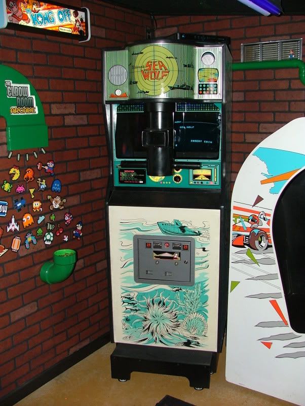

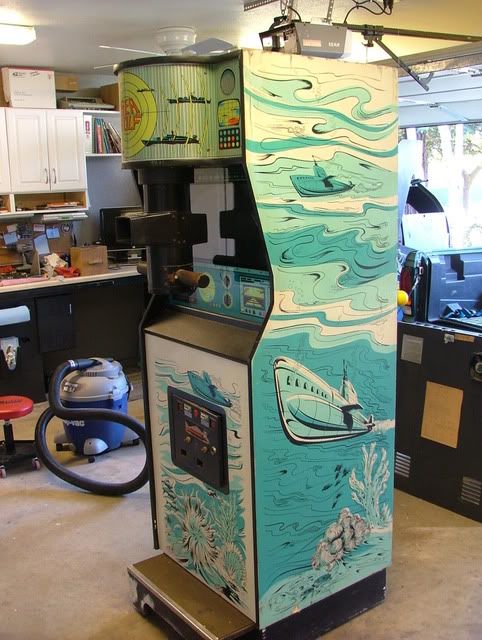

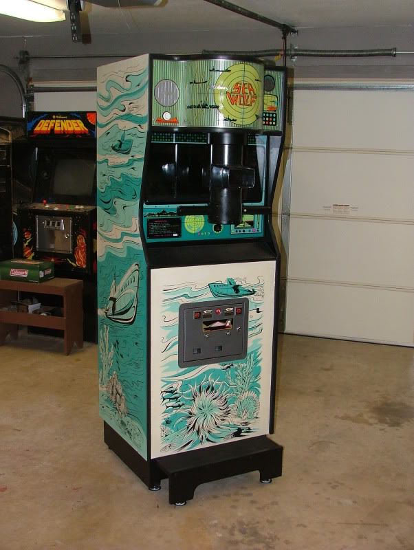

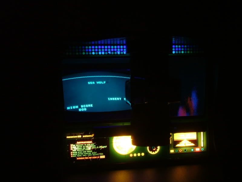

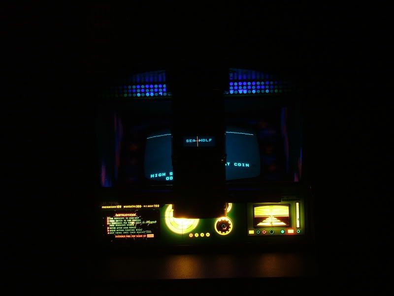

I pretty much finished up today. There's still a few little things that I need to do, but overall I'd say it's finished! I will need to replace the original AMP edge connectors with some modern ones, though. When I first fired up the game, I had garbage on the screen and my heart sank (pun intended). I've narrowed it down to those crappy edge connectors. I don't know why I didn't replace them to begin with. The game is working now, but I want it to be solid, so I'll get a Bob order in soon. One other problem I'm having is the "reload" light is always on, until you run out of torpedos, then the "ready" light comes on momentarily - this is obviously backwards, right? Strange. Anyhoo, here's some pics, and here's a link to a bunch more. If it's sunny tomorrow I may take it outside for some natural light shots, ala Phet.
Before:
After:
A couple more:
It took a bit over a year - I picked this cabinet up (non-working) for $120 on February 12, 2011.
Now I can try to get a decent score - so far I've only managed to hit 4700! Damn this game is awesome, though. I love the EM elements that this game has.

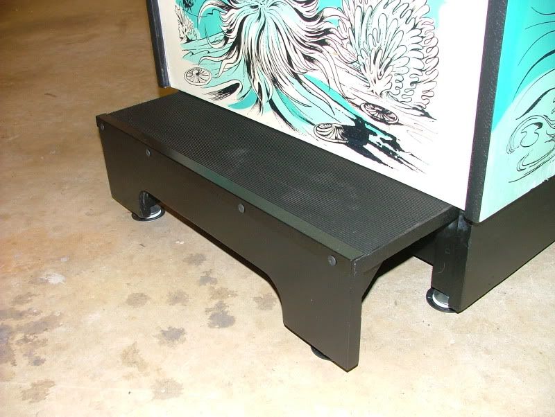

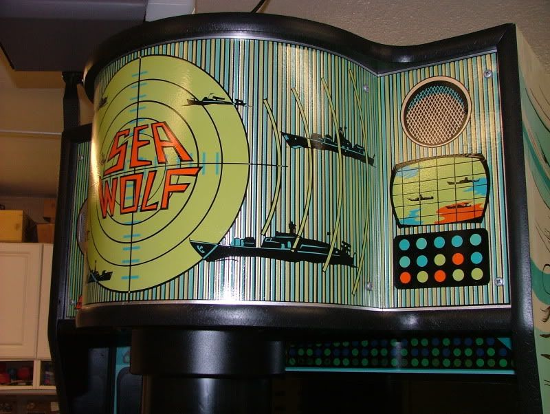

Looks awesome! I like the corner protector on the step. Good idea. I assume that's just some angle iron painted black. I haven't done much to restore it yet other than getting it working and replacing the mat on the step. Did you make a note of paint codes for the matched paint, or did you hand match the paint colors?
Yeah, replace those connectors. That was half the problem with getting mine working. Mine's been rock solid ever since I replaced them.
I see your game has the yellowish target on the marquee. That's what mine had when I found it (it was flaking badly), and I replaced it with a nicer one that Dave (ArcRevival) sent to me from his barn find. It has a more greenish color. I wonder if they started production with the yellow and then switched to green? Or visa-versa? What was the reason behind the 2 different colors? Anyone know?
Is the marquee easy to get off? Eventually I have to tear my periscope apart, repaint and regrease the bearings and all.
As far as mirrors...there's a red plug hanging at the top of the game that if you plug in, will light all the explosion lights to better line them up with the picture.
Thanks Jeff! Yep, the corner protector is just a piece of aluminum angle that I cut and painted. The step had a thin sheet metal strip on it when I got it, so I just used the holes that were already there. As for the paint, I hand matched the colors on the side art, and for the back and top I had Home Depot match a sample that I took in. I found out when I was sanding the back and top of the cab that someone had painted it at some point, so the color I used is not really correct, but it still looks good.
My cab is a low serial number (#523) so if the marquee is the original that leads me to believe that Midway started production with the yellowish marquee and then switched at some point to the more greenish color. Why? I don't have a clue :D.
Yes the marquee is really simple to remove - 8 screws and it pops right off. There is a second metal "shield" behind it that attaches with 6 screws. Then you can get to the periscope. The periscope is a bit tricky to take completely apart, but you shouldn't have to do that if you're only regreasing the bearings. I need to align my explosion lights still - I've just been having such a blast playing that I don't want to work on it anymore. ;) My new high score is 7400! I wish it would save the high score. Hey, you're an 8080 repair guru - what would it take, and would it even be possible, to save the high scores on a Sea Wolf?
Finally moved this beast into my arcade today (it's been in the garage all this time). Here's a few pics - first up, a shot in the California sun:
And here she is docked in the arcade :D:

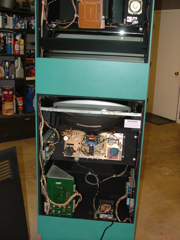

Here's a (small) update. Finally had some time the last few days to work on this a bit. I finished restoring the transformer/fuse assembly and wiring harness. I took it all apart and completely cleaned and/or painted everything, replaced the power cord and the on/off switch, and made some new labels. Looks much better now.
Before:
After:
Now I need to tackle the bondo work on the step...

There's really not much to it - mostly just tedious cleaning. The most technical thing for this piece was soldering the new power cord on :). The rest is just good old fashioned elbow grease. The labels I simply scanned and cleaned up in photoshop, then reprinted them on card stock paper.
