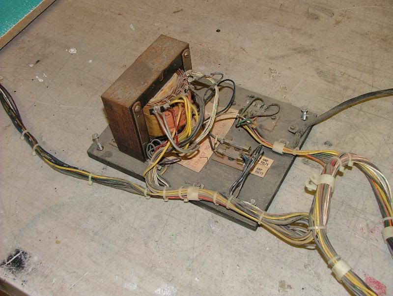

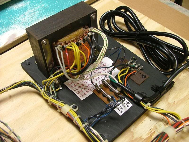

Here's a (small) update. Finally had some time the last few days to work on this a bit. I finished restoring the transformer/fuse assembly and wiring harness. I took it all apart and completely cleaned and/or painted everything, replaced the power cord and the on/off switch, and made some new labels. Looks much better now.
Before:
After:
Now I need to tackle the bondo work on the step...
Holy crap that looks nice.....
Ha! Well put!
Out of curiosity – Did you repair/replace anything other than the main power cord?
I know a transformer is a pretty simple/dumb component, but I always wondered if the Xfmr in my machine is suspect since it might have seen some water back-in-the-day.

I would recommend replacing those two fuse holders on the transformer panel. Midway used some notoriously crappy ones. After a couple decades of aging, the metal clips fatigue and don't grip the fuse ends tightly anymore. A quick check is the "push test" - just push down firmly on the center of each fuse. If the clips spread outwards, it's time for a new fuse holder.
It's part of my SOP to replace the fuse holders in every Midway game that I work on.
You know, I usually do that on any Midway cab I get, but these cleaned up nice and are still quite "springy". However, I'm glad you reminded me, as it will be much easier to do this now rather than wait until its installed and have to contort myself into the bottom of the cab to fix it later. ;)

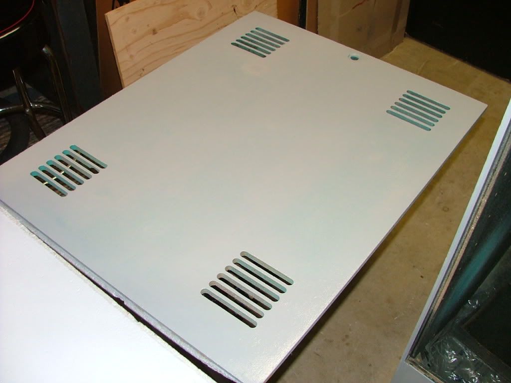

Okay, I've drug my feet on this project long enough! I'm planning on finishing it soon. :rolleyes: That being said, here's a pic of the step prior to painting, and the lower back door with a fresh coat of primer.
I just have to sand the primer, then I can get the top coat applied, then I can start re-assembling everything. I hope all the pics and notes I made are sufficent - this thing has a ton of parts.

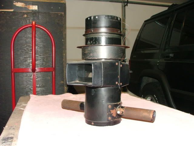

I think I'm in the home stretch now - finshed up most of the painting today, other than the final touch ups I'm going to do on the side art. I re-assembled the periscope today. I thought briefly about trying to light up the torpedo button (since it seems translucent), but I decided that would be a future project.
Periscope before:
And now:

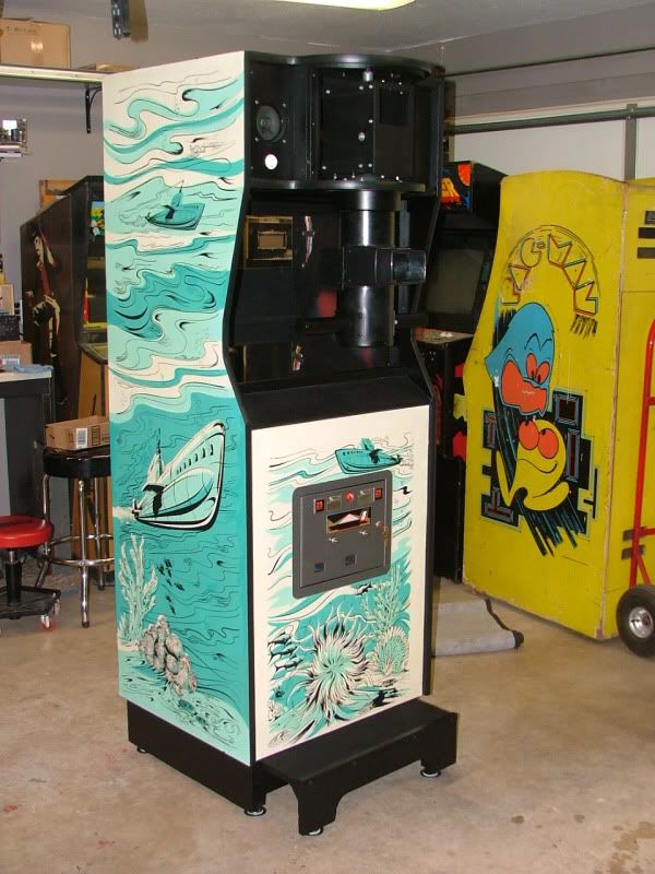

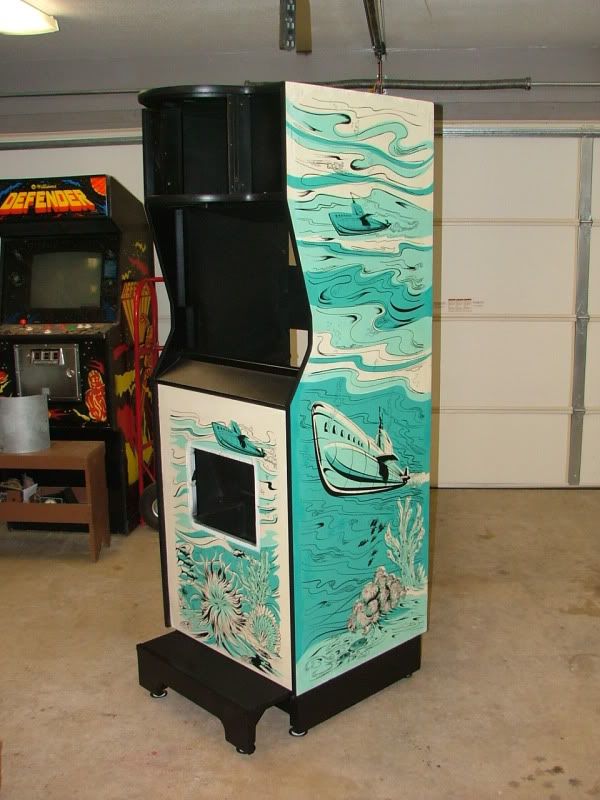

Almost there! I put the step back on, touched up the side art as best I could (damn those colors are difficult to match..) and put on a couple coats of clear satin. I triple thicked the bezel, as well as the marquee (thanks for the tip John, it looks great!). Put new "tread" on the step and installed the new t-molding. I should have time tomorrow to (maybe) finish her off... Lots of little things to do still. I need to cap the monitor as well (it's only about 7 caps, so that shouldn't take long). Here's a pic of how she sits now:

Here's the latest pic - all I have left is to put the monitor back in, and mount the mirrors. Tomorrow I should be sinking some ships!
