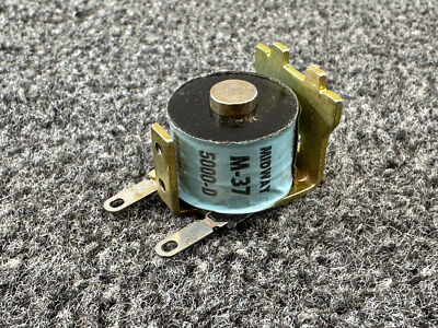

Hey all, is there any place to be a complete assembly of the circled relay in the arcade game sea devil? The whole thing is basically burnt up and it needs to be replaced as well as a new capacitor as you can tell

Your picture is blurry, and I can't see the damage that you are talking about. The coil does not look to be burnt up. Have you tried cleaning your contacts or filing them down a little bit?

If you zoom in that wire in the very front of the one circled is no longer attached due to that black area crumbling to pieces
It does look pretty toasty.
If you haven't gotten to know Steve Young at Pinball Resource... good time to start! He likely has some Midway relay units, and can custom wind that funky 5000 winding coil.

the coil seems fine as it was trying to atleast work, but with that piece being broken it couldnt, i guess lock on, not sure the right term, when i moved that wire the black part broke and was crunchy, they said it worked for a month when they got it but then stopped and this is the reason

Those relays do get a workout. Once you get that relay replaced you're going to want to make sure it's not "machine gunning", or you'll burn up the new one quickly.
If you don't already have them, get a manual and schematics from Steve Young.

i found a copy online and i am pretty surre thats what cause this one to burn up, it needs that cap below replaced as well not sure if thats the reason it did that, the owner said the game was found in a warehouse and they brought it to their drive-in and it worked for about a month before it went crazy and stopped working

Good luck with the online version... I find them really tough to work with for stuff like this... and I've been doing it a while. If you're new to games like this, I think you'll find it's well worth the $ to buy a decent paper copy. Pinball Resource is good about providing highly legible schematics in the original format... usually a huge fold-out document.
Regardless, you're going to want to figure out what makes that relay go, and get to the root of the issue. Good luck!

still haven't found a replacement, if that black piece could be 3D printed I would try that and replacing that bad cap to see if that would fix it
I have that chassis off of a Midway Bullseye. This also might work. It has a 24VDC coil. It is glued on like my other one. The one on E-bay is the correct one. You would have to free one of these and then get that donor. The one on my Bullseye is 12VAC.
Right now, I am heating the oven to 170 to see if the glue loosens without destroying anything.

It took 250 in the oven to break the glue loose. The coil does not look any worse for the wear. The bad news is that the coil is glued then riveted for the 24V coil.
My Midway one is screwed on. The solder needs to be removed and then slid over the tabs. Is this how the Sea Devil is?

That I don't know, I mostly need the bottom black piece as it has crumbled into dust, I really don't want to remove it without a replacement but I may just have to remove it and see about remaking it in 3D and see about 3D printing it
I made the observations on my Midway Bullseye without removing anything. You can look at your relay and tell if it has removal screws. That would allow you to remove it and leave the solenoid attached.
