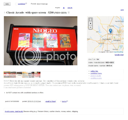

Hey guys,
Lazy day working on games when I get a CL alert on a cheap 4 Slot Neo Geo. This game is on the short list of games I have been looking for and I figure at this price, I can't lose. Cant really tell much from the photos, but he does mention "2 new screens" which sounds odd. I give the guy a call and luckily I am the first one to commit. Drop what I am doing and make the 45 minute drive to his house...
I pull up and he has the game in the back bedroom. I ask him what he means by "new screens" and he points out 2 brand new 25" CRT boxes in the corner! He still has the monitor that came with the game and I ended up with 2 NIB Nanao-26SU 26" monitors as well! :)
The game has a dead power supply and I need to figure out how to wire the new monitor in, but it was a pretty good score for $200 total!
I shot a quick pickup video as well. Game is in excellent condition aside from the dead power supply and the need for a new CPO. No water damage or broken areas at all! Included 4 games, original manuals, etc...
