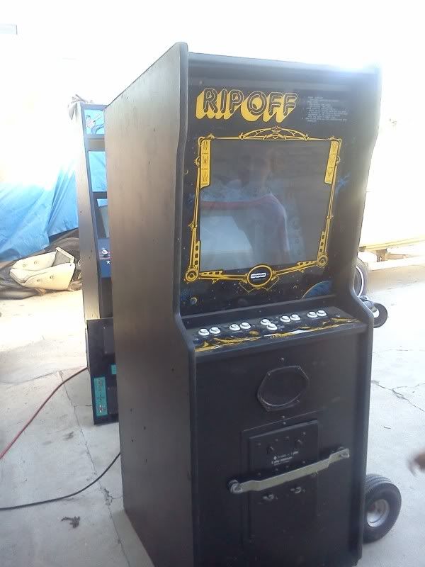

1. rip off has a blown fuse so i need to go buy some fuses tomorrow so i didn't even plug it in. i've wanted one of these for a long time.

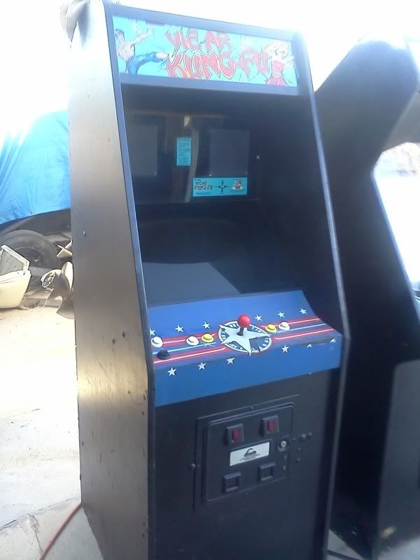

2. kung fu has no picture or sound. can anybody confirm what cabinet it is? it does have the spots for the timer boards in the speaker panel. its for sale

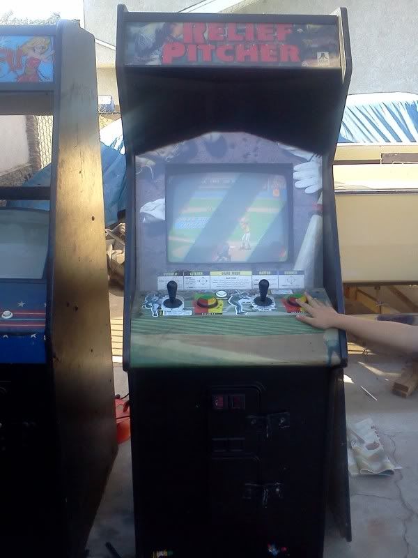

3. relief pitcher in a millipede cabinet, it is jamma wired and works 100% with a nice picture. it was a street fighter at one point by the look of the control panel. its for sale
well i put new fuses in the rip off and it came up. the board seems to work fine. the monitor came up but everything was squashed into a line across the screen. it was nice and bright though. then the resistor at r118 on the chassis blew then the cap at c4 went right after. i need to buy the resistor and cap and try again. also check the molex connectors as that might be the problem, hopefully. anybody have any experience with these monitors?
