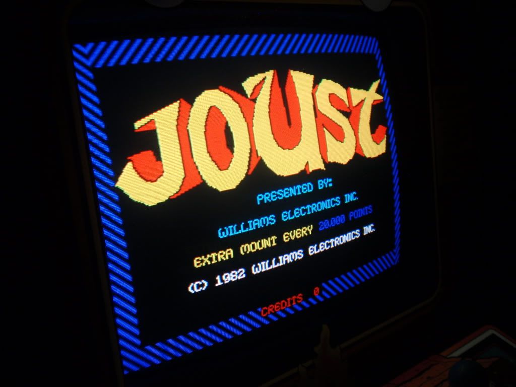

Weird, the monitor in my Multi Williams IS a 7200 with a Daewoo tube from a 19 inch TV. Do any other tubes work for those monitors? That combination has a great pic:
what TV and tube numbers did you harvest from?
My 19" K7000 is a CR31 type neck and this is K7201 is the fater one like a CR23.

thanks, I've been looking for Daewoos that had the A48JLL40X thinking that it would work in my K7000 with the thin neck tube (CR31) but it looks like it won't work then.
For the record, any CR-23 necked tube should work.
Also, the 7201 does not need an isolation transformer, but can be used with one with no problems.
