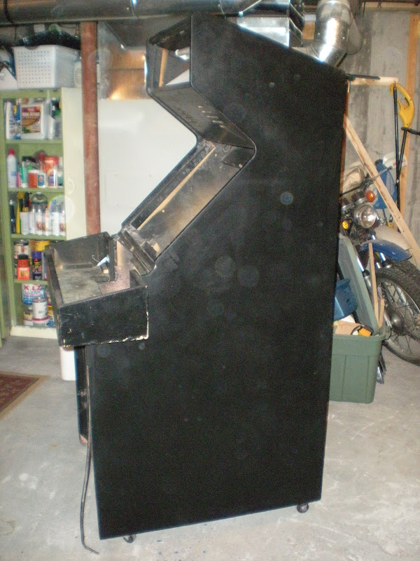

Ready for the 1st coat of paint

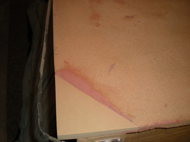

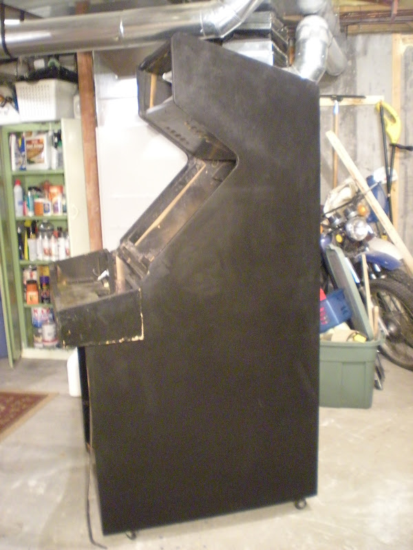

The sanding bondoing, patching it all done now time for the paint!
Here is the repaired corner:
All ready for paint on this side, note the top of the cabinet where I tried Goo Gone it darker, I hope the paint will stick.

So the paint takes 5x as long to dry where the goo gone was used! :mad: I am just going to wait for that last coat to completely dry before I put on the last coat.
from the look of the shine it looks like you used an oil based paint? I find oil based paint takes the longest to dry 24 Hours +
Semi-Gloss Latex you can get away with putting another coat on after a couple hours.
Flat Black Rusteolum thinned with mineral spirits. Actually it drys in about 4 hours, but the top took overnight. I sanded and applied another coat and it looks good.

Both sides done...
