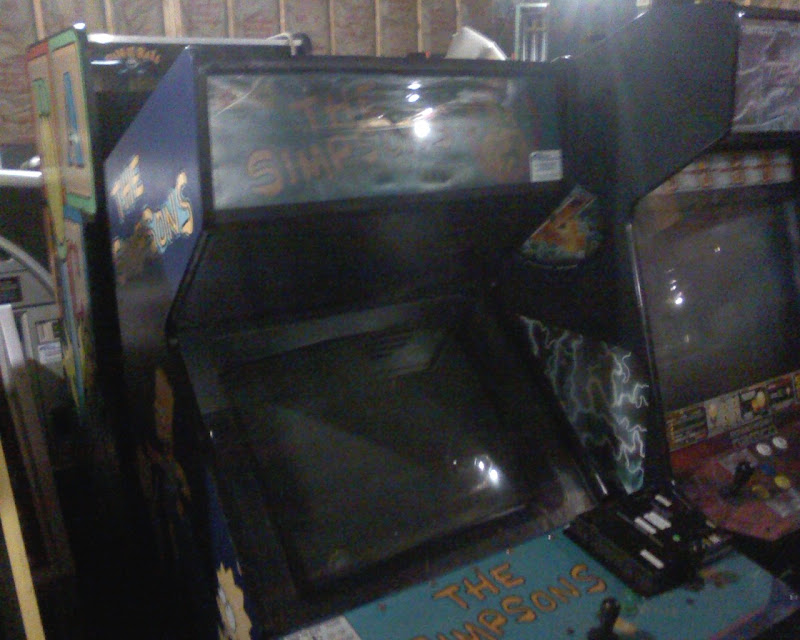

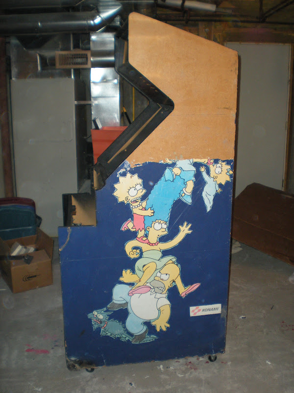

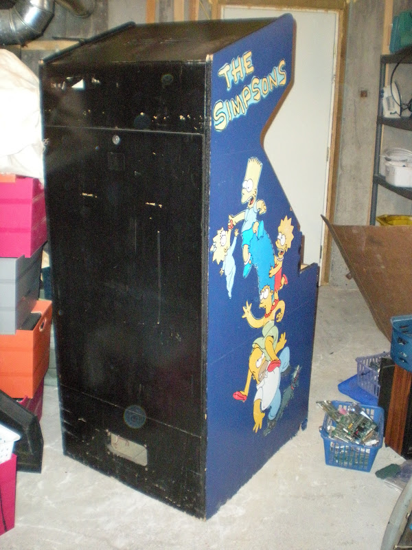

Recently I organized a warehouse raid, and SRW got a really beat up 4-player Simpsons. All the insides were good, but the cabinet was beat! I helped him part it out and he gave me the empty cabinet.

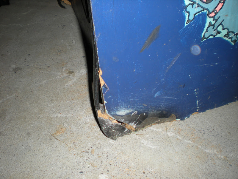

The right font bottom corner was destroyed and fixed with fiberglass, which broke too. The OP painted around the characters with dark blue paint, and the characters are all faded and tore up. It looks like someone tried to pry the top of the marquee off with a prybar and that is patched with I don't know what.

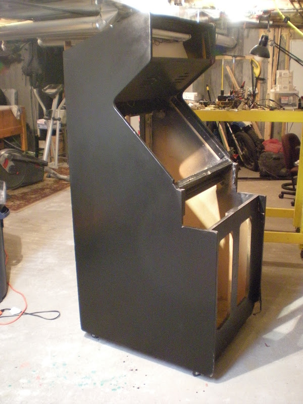

I don't want to spend the money to restore this back to a Simpsons, so I am just going to patch it up and paint it black. I have a nice 27" VGA monitor, and this will make a nice MAME/XBOX 360 cabinet.
So far I have sanded/bondo/painted the left side. The right side is in much worse shape. I have borrowed my father's biscuit joiner, and will replace the bottom front corner with it.
Here is the left side, I painted it with Rustoleum Flat Black, and rolled it on with a foam roller. I saturated the roller with mineral spirts before putting it in the paint. It rolled on well, and now it is drying.
I am not going all out on this since I am just MAMEing it, I just want to make it look decent in my arcade.

Yes I did, good memory! Yah, it really is not worth it, but even if I change my mind, All I have to do is lay the Simpsons artwork over top. But for now it is too ugly, and needs structural repairs. What I didn't realize is that the original artwork is in 3 pieces. The replacement artwork you got, was it one piece?

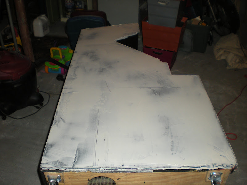

Paint came out good but...
...you could still see the lines where the OP had masked off the Simpsons characters and painted, even though I sanded the snot out of it. The razor lines are deep into the vinyl. So I have decided to try coating the side of the cabinet with drywall plaster. I mixed it thin and smoothed it with me huge Stanley square. It reminded me of working concrete. :D Then I will sand it smooth and put on another coat of paint. Hopefully that will help cover it up. Mostly an experiment since I don't want to peel off the old vinyl.

I have the left side done!
After 4 coats of paint, bondo, sanding, plaster I have the left side looking good:

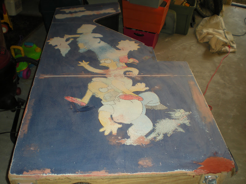

But after all that work, I decided that leaving the vinyl on caused most of the difficulty. So on the other side which is in worse condition the vinyl is coming off. As suggested the heat gun makes it super easy!
Whats up next

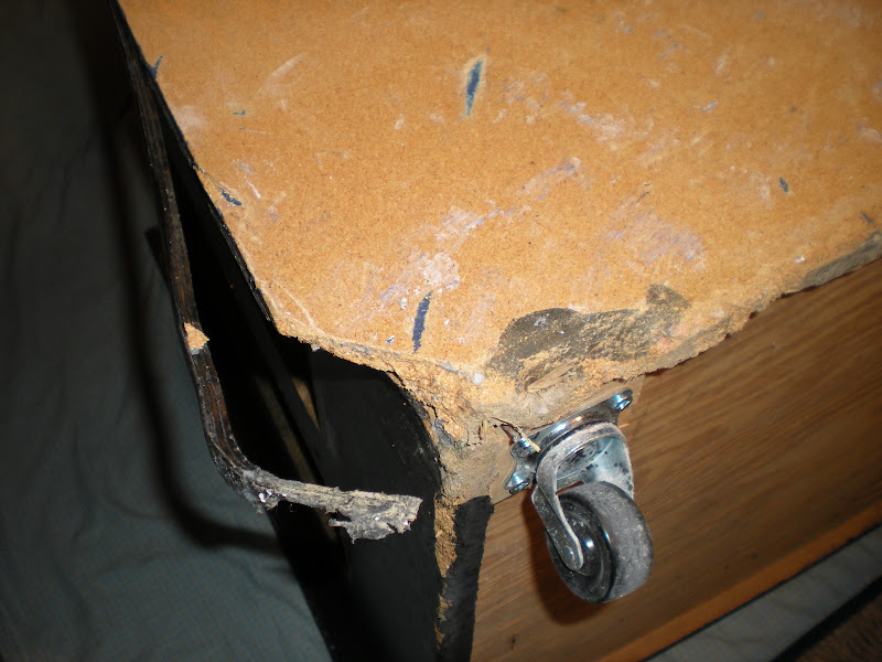

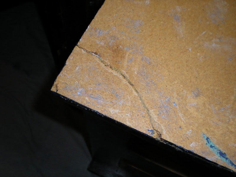

I got all the artwork off the one side and now I need to fix up damage to the cabinet before painting it. I will be using the biscuit joiner for that. Also I have to figure out how to get the adhesive of the cabinet which didn't come off with the heat gun. If I put the belt sander on it now, it will just rip the paper off the sander.
Here is a broken and reglued but the OP area under the control panel box:
Right front corner:

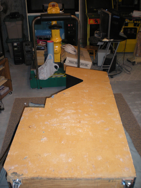

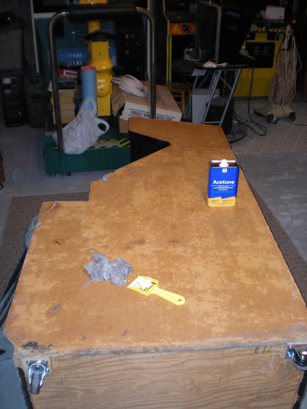

Got the adhesive off, and fixed the corner.
So I found that Acetone works wonders on removing the leftover adhesive. Don't use oil based removers like Goo Gone, it soaks into the "wood".

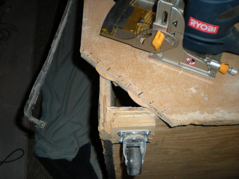

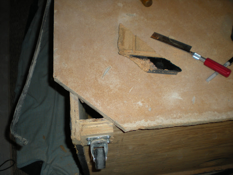

I used my father's biscuit joner to add a new corner to the cabinet after I cut off the damaged portion:

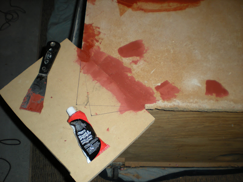

All bondoed, and ready to be cut:
