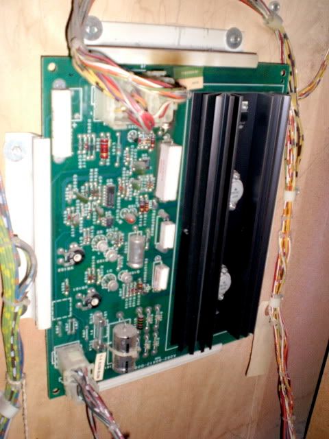

Just to make sure I'm on the same page (like I said, I'm new to this), we're talking about this guy (the PS board), right?

All the fuses are fresh (just replaced them today). The voltages failed virtually everywhere, so I think the PS is the culprit. There is some burn at the top of the board (you can see it in the top-center of the pic), so it's probably toast.

Bad diode on the power supply.
Put new fuses in the power brick and use the Tron power supply to see if the fuses still blow.
