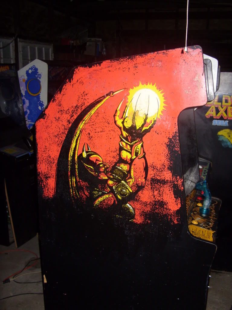

Didnt know if this was going to be possible:eek:
Who called my name??
Wow, does the black paint come right off??
Think they didn't sand it before they painted it, you in luck!!!
Looking great!!

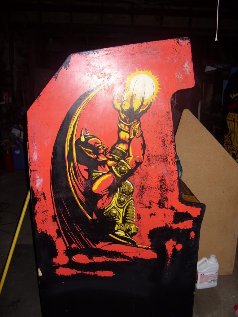

No it isnt coming right off. it has taken multiple coats. Thats about 4 -6 hours of work. Im taking it slow because I have never tried this, and I dont want to lift the art off.
Are you sanding or are you scraping it off?
It looks awesome the way it does in the pics like a hidden treasure that apears or like a secret image that apears like what you see in movies.
No Sanding. I spray on the paint graffiti remover, and wait a hour or 2. Some does peal off easy, the rest I buff off with a soft cloth. It seems like its talking forever, there may be faster ways but im ok with the slow progress.

It feels great!!! I was thinking I would have to stencil. Now Im going to be able to save the Devil. Im going to have to do some touch up red, maybe all the red to make it look right. but the original Devil will be saved.

Here is a link to what im using, only dont follow the directions on the can or you will lift off to much paint, I found that out in a non critical area. just spry it on lightly. let it set for a few hours. after the majority is off dont respray use a cloth and some paint thinner to remove the little stuff.

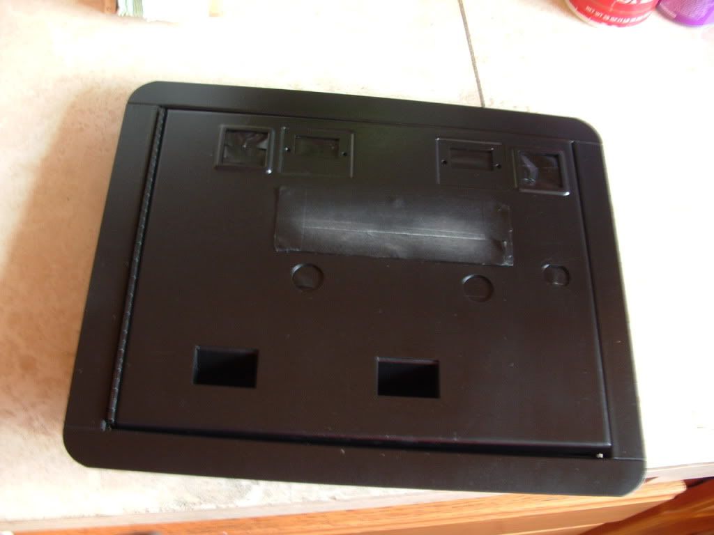

I repainted the coin door a few days ago.:D Cleaned the inside, and added a different 25c tab to replace the cracked one.
