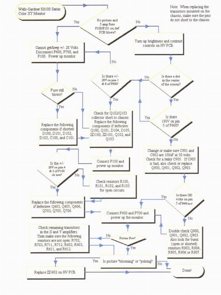

I've got 130v B+ after a cap kit on a sanyo.
Any clues what would cause this? The B+ doesn't seem to adjust either. I'm going to pull it back apart and re-check the caps first, I suppose. I don't have a flowchart for these, so i'm not sure what to look for next.
There is currently NO such animal. Do a little thread searching, I have covered this recently in a bunch of Sanyo threads.
ORLY, Dokert??
So, something like this???
(I know, not for the 20EZ)
But are you talking about a troubleshooting flowchart or a flowchart about the monitor?? The schematic is more like a flowchart of the actual monitor.
The OP appears to be looking for a guide as to what to do next because his B+ is at 130vdc, kind of like the info that you are looking for in ref to your B+ being 80vdc.
Your problem is very easy, and I was hoping that you would do a little research. Your Fly is bad.
The OP most likely has a bad Current limiting trans Q901.
