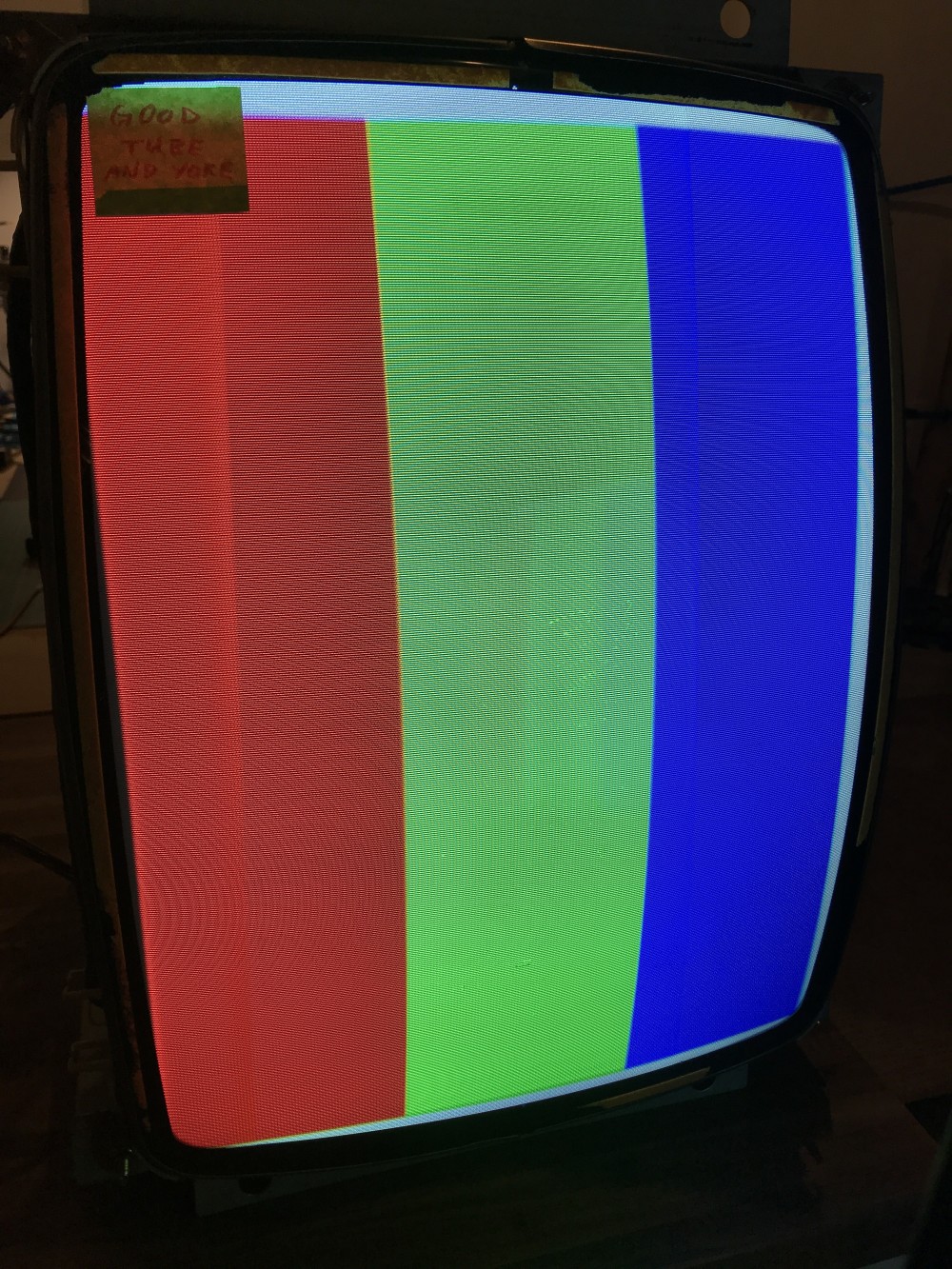

So I bought this 20EZ from a guy on craigslist who had it in a VS machine. He didn't know anything about monitors so he said that he had another guy cap the monitor for him. Well he says it worked fine for 2 months and they went into vertical collapse.
So when I got the monitor, I noticed right away that TR402 was not right. So I swapped in another and now I get this picture.
And.... after tweaking some pots, this is the best I could make it look:
I'm pretty confused right now because I seemed to have gotten rid of the vertical collapse. (sort of) but I'm not seeing any image from my Test Pattern Generator. And my B+ is at 110VDC.
I have already ordered a new cap kit, filter cap, B+ pot and new transistors (TR402 and TR403) but I was just curious of anyone has seen this kind of picture on a Sanyo before? I really have no idea if the previous person's cap job was done correct until I put my caps in but I just wanted to know if anyone has seen this behavior before. I don't really like those lines down the left side of the screen. That looks like it could be related to the yoke. And the jittery waves on the edges of the screen are also weird. (Not to mention that the chassis doesn't want to show an actual image)
I also didn't notice any obvious cold solder joints or broken traces (yet). And there are no cracks in the board. I'm also fairly certain the tube is ok and the yoke ohms out ok as well.

I worked on this chassis over the weekend and made some baby steps. (The screen doesn't wiggle anymore) Maybe your assessment of my situation will change after seeing my latest image below.
So I got rid of (some) of the vertical collapse by replacing TR402. The one in there previously wasn't even the correct model number! LOL.
I also completely re-capped the chassis...including the large filter cap. It's worth noting the last person did a really terrible job capping this monitor. Not even all the caps were replaced and I think some were even out of spec.
I also replaced the B+ POT...and the voltage is currently 108.5VDC.
But...I still have the same image I did before. So the bad news is that the cap kit and new B+ pot didn't fix it. But the good news is that I didn't make it any worse. :)
Here is what the picture currently looks like. This is pretty interesting because it looks like it's still in partial collapse. The image will not fill the screen completely from left to right (vertically when the monitor is oriented horizontally) AND I'm getting these narrow white lines down the left side of the screen. (I already know the picture is way out of focus and needs to be converged too)
I've tested another known-working chassis on this monitor and confirmed both the tube and the yoke are good. So this issue is isolated to the chassis.
Adjusting the horizontal hold and the vertical size pot does move the picture around...but does not make it any better.
My next guess is going to be re-flowing the entire chassis, or better yet...replace TR403 next.

I have fixed the problem with this monitor. It turned out to be far more easy than expected....but I was just shooting myself in the foot.
I decided to take another look at TR402. But this time I pulled another known-working chassis to compare with.
Here is the reading of TR402 on the working chassis. Looks good to me!
But here is my reading on the broken chassis. Yea...that's not right at all.
So I had another 2SC2073 transistor and took a reading from that one before installing it. Looks good!
My original hunch that TR402 was the bad part was actually correct. BUT...the original transistor I put in there was only HALF working so it literally only fixed HALF of the vertical collapse.
As soon as I used a working transistor, it obviously eliminated the collapse.
What's the moral of the story? Test your parts before you install them or you will wind up chasing your tail. :) Also...make sure you have a good 9v battery in your TPG.

Just a final follow up...
I got the pictured all calibrated and cleaned up. Luckily I didn't have to adjust the yoke. I just needed to adjust the purity ring and got the colors looking nice and vibrant. Also good news because it doesn't look like this tube needs to be rejuvenated. :) I just really love how good the picture looks on a Sanyo.
Oh and those green lines I was seeing earlier on the checkerboard pattern was just because the brightness pot was turned up too high.
Now I have my 2nd spare Sanyo I can stash away for a rainy day. :)
(The lines in the picture are just a reflection in the mirror I was using to adjust the monitor)
