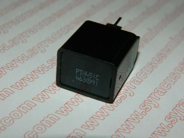

I picked up a Sanyo 20EZ, and it hasn't been powered on. I washed the tube and chassis, and I also recapped the chassis with the kit from APAR. Changed the HOT as well, and installed a new B+ pot, and filter cap. The chassis looks clean as a whistle, but before I power this up, I noticed that there's a missing component that left some burn marks on the chassis at PS601.
Both of my other Sanyo 20EZs have this part, so should I install one before I power this up? What's the part called, and where can I get one if it's required? PTH451? Some kind of a thermistor?
Can I power up the monitor or without this part installed, am I going to blow a bunch of stuff up?
