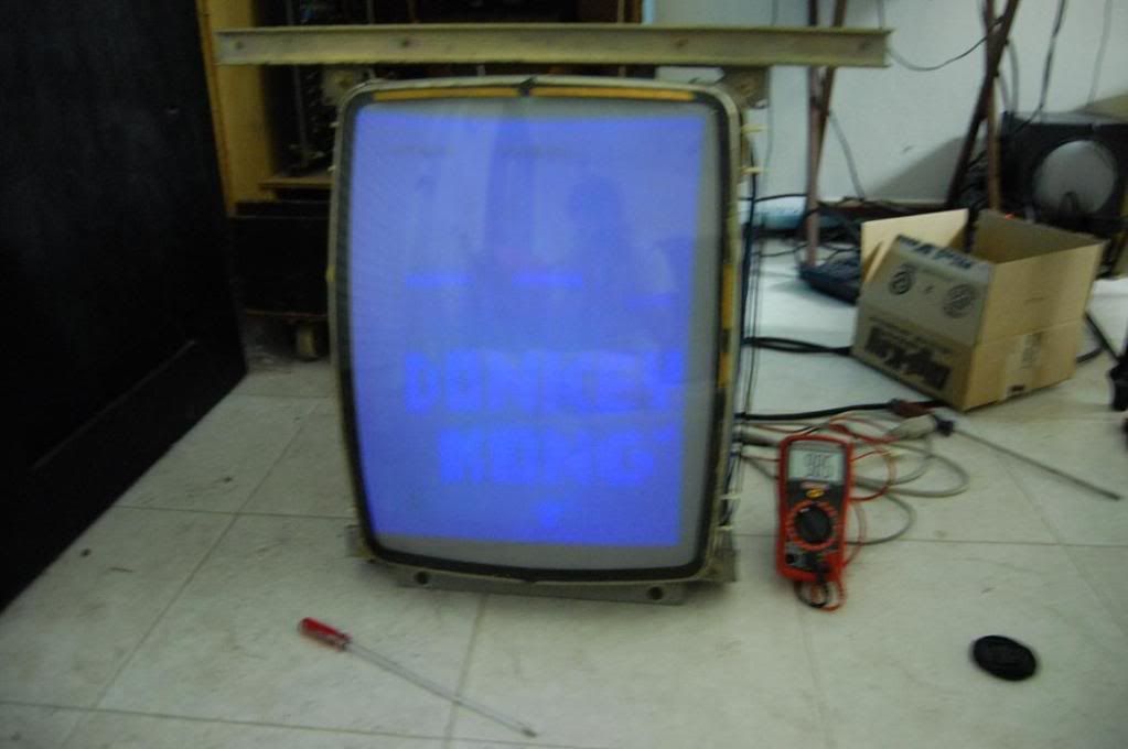

I have turned up all the pots and made some adjustments and heres what I'm able to get:
It's very blue. It's about the only color I can get. No matter how I adjust the bias's on the neck board the color doesnt change.

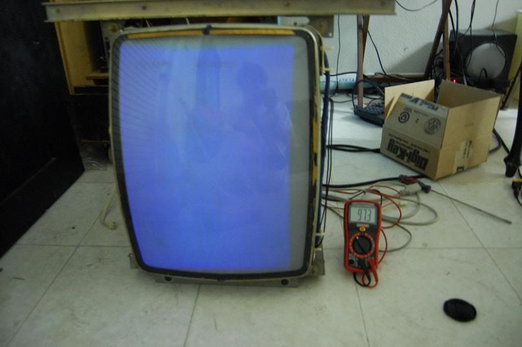

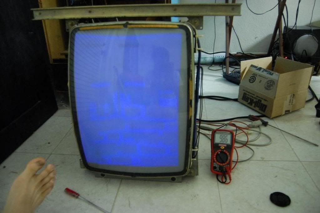

With no signal from the board I get this:
The B+ voltage is shown on the volt meter in each photo. Still pegged right around 100 volts. No change from the B+ pot.

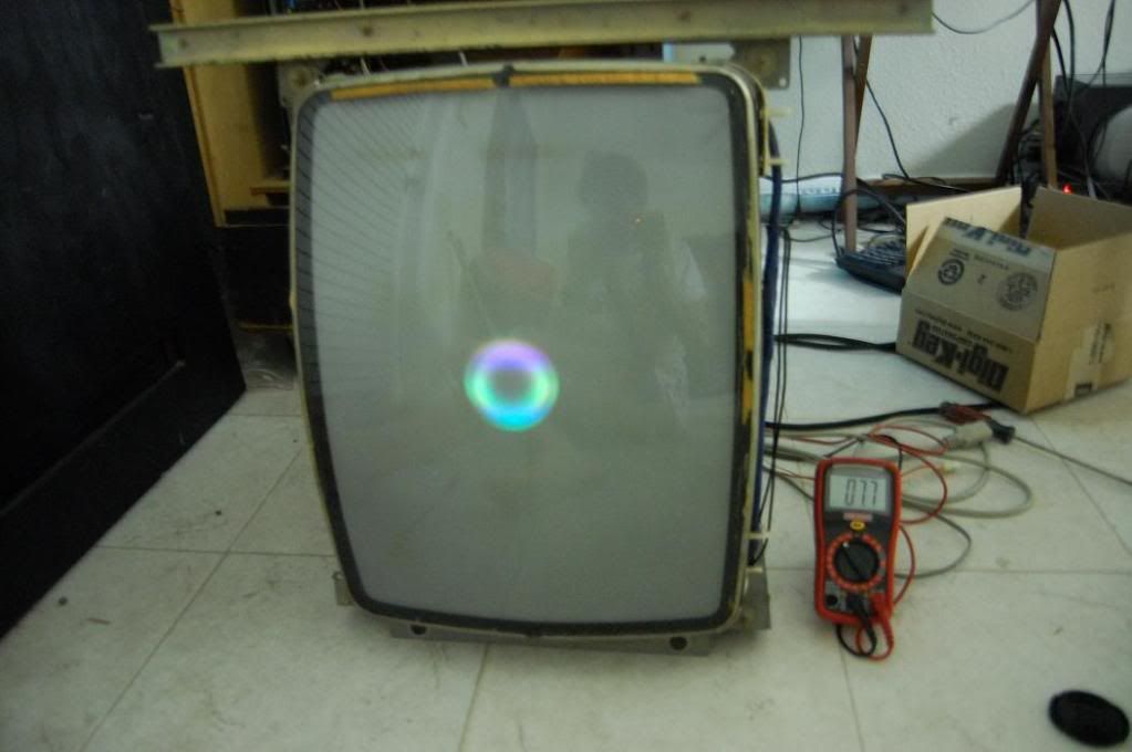

Also anyone have any idea what this is:
This happens when I turn the monitor off. Regardless of whether the monitor had a signal from the board or not this shows up on the screen after it's powered down. It's kind of weird and somewhat creepy. It sticks around for a short while. Anyone? Thanks!
Things I would check, neck board ground, broken color pots Red/green. Bad header pin solder joints. Are you using an inverter? If so disconnect it and plug the cable directly into the chassis. Your B+ should be 108VDC which I'm sure you know. But low B+ will cause all sorts of weird problems. Recheck your solder joints in the B+ section. Is the B+ pot good?
Yea, all the adjustment pots and the b+ pot were just replaced by ones from bob roberts.

Hello, there really isn't much for the color drive circuitry so figuring out that should be much of a problem. I hardly see color problems with these so not going to start suggesting.
For semiconductors, looks like each color drive uses 3 transistors and some diodes. I would assume semi's. Are you getting that blue filled screen with a game signal attached or is that powering up only? If it's with a game board then your game board is likely at fault... As for the 100vdc that is enough to give you a clean image without problems... For the creepy ring, not sure but I am guessing an open might be on one of the electron gun paths back to the chassis. / neck socket. Your symptoms are certainly not common... if you hit a dead end, I'll gladly take care of it for you. Yes, I will be merciful on the repair price since you have some work put into it...

The screen is blue with no game board attached. I suppose I'll look into those transistors on the neck board. Fixing this game is on hold at the moment as I'm moving all my games this weekend.
