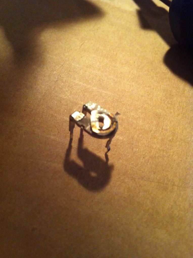

Well, I FINALLY pulled the monitor chassis last night and checked diodes (good) and the B+ pot, which measured as essentially open. They put that dang epoxy on it and I'd guess that ruins it as you do tend to have to adjust after a cap kit. I'm really surprised it worked as long as it did after the cap kit!
Thanks Dokert! You nailed the cause! 140v dropped to 108v with no issue with the new pot.

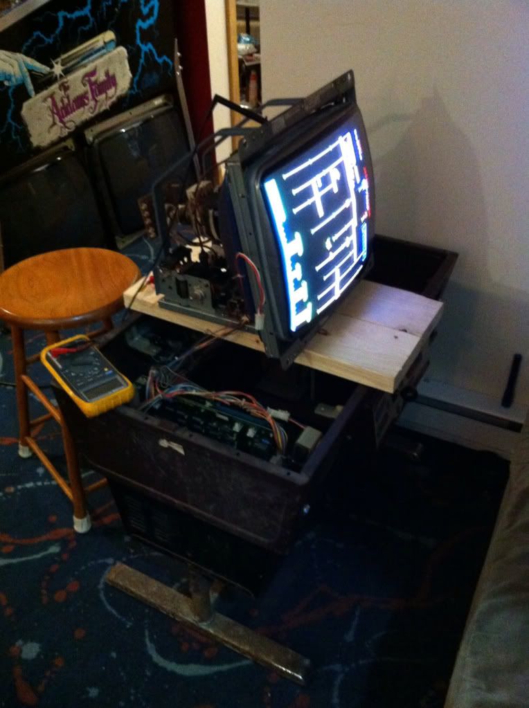

Pics for fun!
I am really liking this DK Jr. Nintendo table, it can run Donkey Kong, DK Jr., and Popeye upright boards with no wiring changes! Plug and play (except Popeye needs the monitor rotated!). Power supply and harness works fine for all boards.

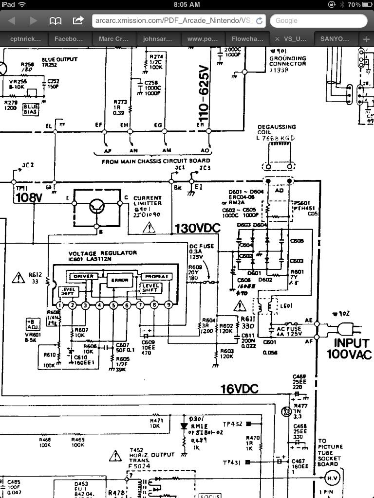

So, it works for a little while, got a few games of Popeye in at least, then I turn it on last night and it comes on for about 30 seconds then turns off, HV Shutdown again with a B+ of 137v. Newly installed POT does nothing to help.
In one way I'm not surprised, the original POT was bad, but I'm thinking that me turning it full range to see if I could bring down the voltage is what got epoxy under the wiper. In any case, a few questions for those that know better than I:
1.) Is it possible for a bad regulator to "come back" if set for a couple of months?
2.) Wondering if bad solder is the culprit, maybe it worked again after I had moved the board or whatever.
3.) If the 300mA fuse has bad contacts, would voltage rise or fall?
4.) If I replace the regulator and not the current limiter, is it possible to damage a new regulator if current limiter is bad? (I can replace the regulator without removing the chassis pretty easily.
Thoughts?
Current plan is to check the new POT, then look for bad solder joints, check B+ voltage, then replace the regulator, check B+, then replace the current limiter. Hopefully all will be good once I get B+ back to 108v.

I am stumped now,
I took the plunge and replaced both the regulator and the limiter and I still get the 140v!!
Adjustment pot is still measuring OK.
NEW VR601
NEW IC601
NEW Q901
Cleaned DC 0.3 amp fuse holder - measures good now.
SO, what next?

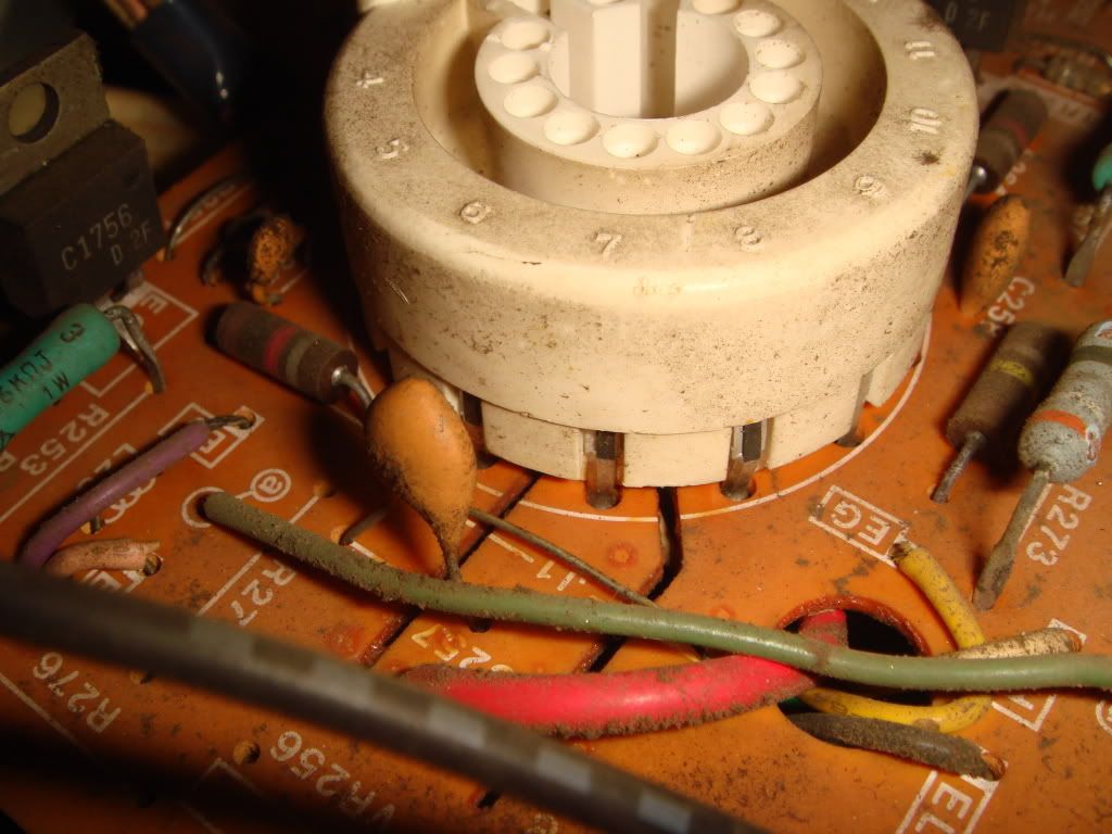

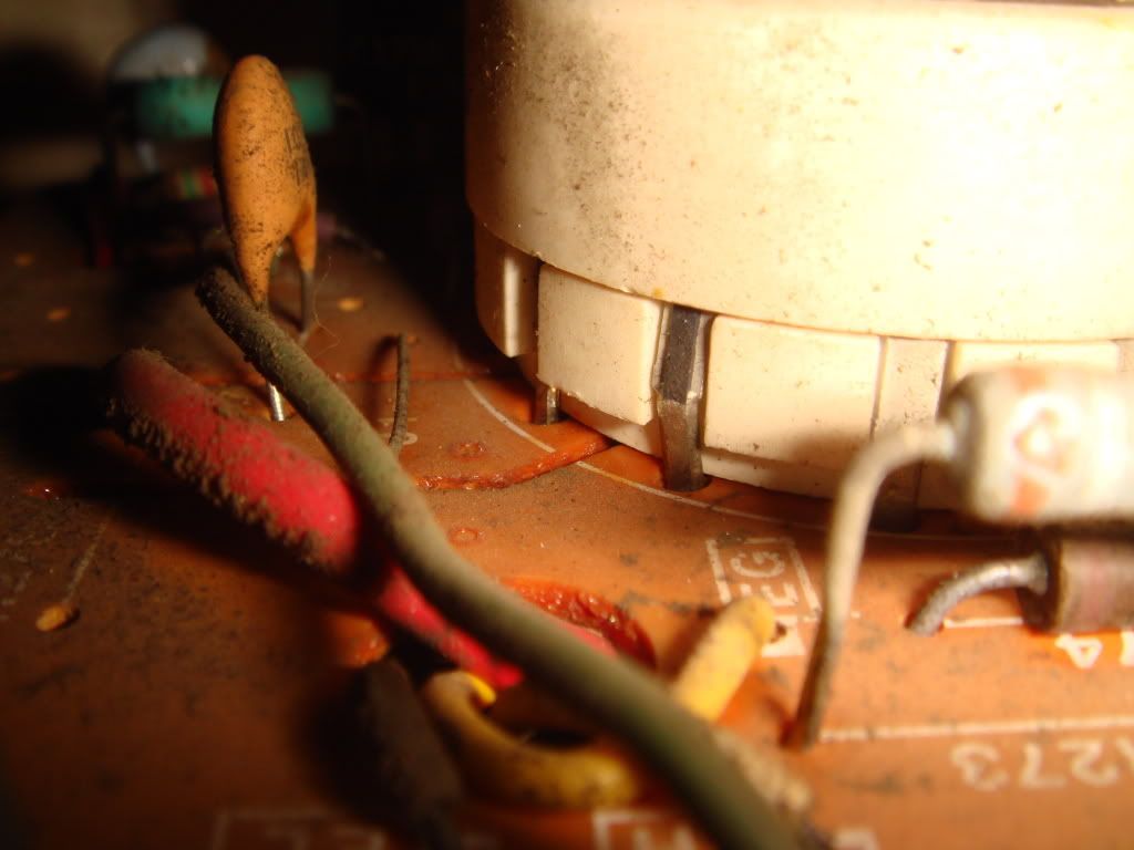

Well, took some pics of the neck board.
I didn't spot any visible bad solder, but the neck socket sure looks like it's been repaired to me. I'm thinking that it is possibly the socket, the tube pins did not look so bad when I took a closer look at them.
Does the socket look to be patched??
