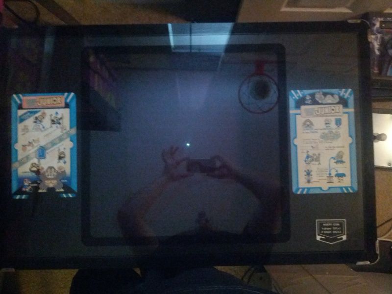

Recently capped my Sanyo 18" monitor that is in my DK JR. Cocktail Cabinet.
After getting everything back together and put back in the cab, all I am getting is this.
http://i14.photobucket.com/albums/a324/X_EGO_BRAIN_X/IMG_20120807_104425.jpg
I've double checked all connections and everything is plugged in properly. The safety switch is also not engaged on the chassis.
Any advice on where to start checking?
Thanks for any help!

The only time I have seen that is when the yoke connector is not pushed down tight.
You all were right!
I pulled the monitor out, resat everything (More firmly this time) and now I have a perfect picture!
Thanks for the help all.
