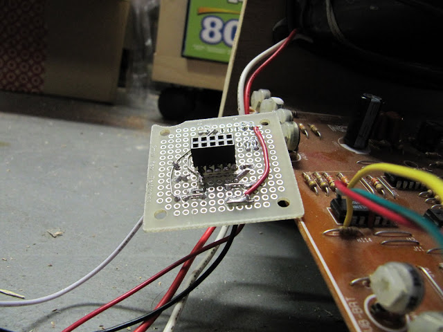

First I mounted up the monitor so that I could work on it. I built this small frame so that I could work on the chassis easily.
Even though no one did a a formal guide, it wasn't TOO technical. I followed the bread crumbs and built all of the components onto a circuit.
I went about it differently cause I mounted a 10 pin connector on the bottom of my board and used it so that this little board would sit on the 10 pin header as a plug in solution.
Shown here w/ no chips but mounted. I did it this way that way I could produce nearly plug in kits. It's a bit of work however.
I was out of blue wire in this size... had to go w/ yellow.

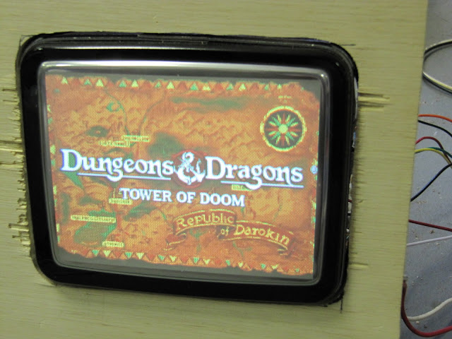

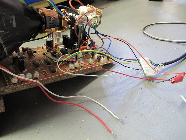

Here it is all together with wiring connectors. 12v, 5v and ground also are left bare.
Here are the results
and a closeup of the tube.
I did not hookup the contrast pot and still need to do that. (need to get the pot first) I wanted to see if I could light up the monitor first.

It took me a couple of hours to do this one and figure out the best way to build my plug in board.
The rest will go faster and be more clean since I can clone it now.

I finally got around to testing this out and it works out OK.

Quick Test rig
I threw the parts on a piece of driftwood and used some tape to hold her down. Kidding
I fixed the bits and pieces to a piece of wood so I could test and refine more. I have a vision of what the test rig should look like and be able to do. It wont be huge, but its not tiny either. Can be used to test boards, monitors and cabinets with the right pieces installed and a few cables.
Let me know if someone sees something wrong with the setup. I will be making a few of these just to practice and experiment with the process. The end result will be much prettier though.
