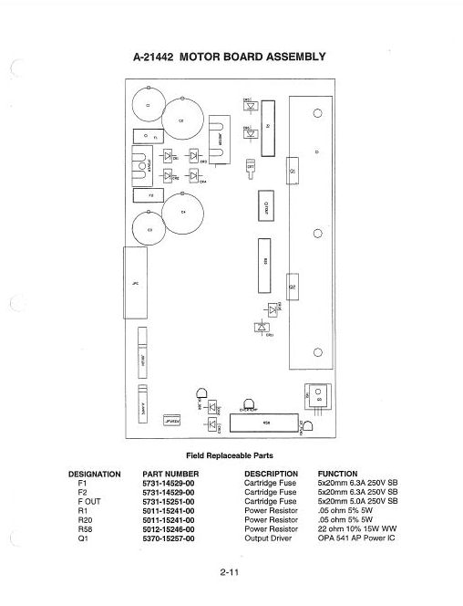

From the manual, it shows some fuses, some power resistors and the op amps as field replaceable parts. I would assume those are common failure parts. I think there is a mistake, in that Q1 and Q2 are the op amps, not just Q1. I really didn't think about 1 of 2 power resistors going bad and doing an open circuit. I might have to pull a leg on each one and measure the ohms. Below is a page from the manual.

Hard to tell what is going on with it with out a wiring diagram. The Op-amps and the TIP are connected electrically at least, I know that. The Q2 has those wires on it, guessing that is how the overheat circuit is activated? Just a WAG but I'd bet the Q1 is the bad chip, else the overheat circuit would hacve kicked in before things fried? Who knows..... Basement let me know what happens when you swap those out.....If those Op-Amps don't fix it, I'm guessing the TIP will....pretty much HAS to be one of those 2 parts? Good news is those TIP-120 are less than a buck a piece....

When I had mine, I was less knowledgeable about circuit repair, you could always test that tip120 with a meter, and also with a diode tester you could probably compare values between q1 and q2 if you took them out of circuit. If one's bad, you'll get different readings.
