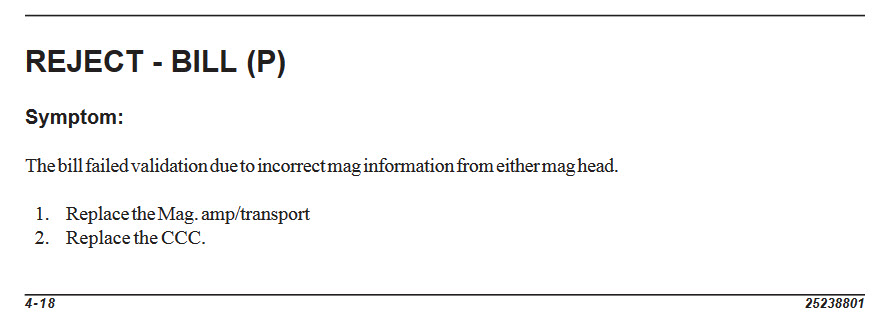

Anyone have a list of the error codes for these ???? I'm trying to remotely diagnose this so I have the correct stuff with me when I go there ...... Location is telling me all 3 bulbs are lit for the sensors but the display down bottom is displaying a "p"..... I have no clue what that is
http://arcarc.xmission.com/PDF_Coin_Mechs_Etc/Rowe/
http://arcarc.xmission.com/PDF_Coin...-3500_Bill_and_Coin_with_Fast_Pay_(Rev_N).pdf
see Section 4 for all errors
