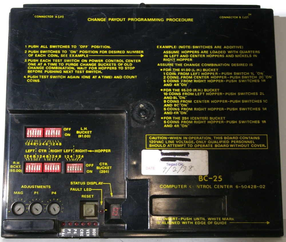

If it's the more common BC-25 model, then everything inside it makes it super easy to test and diagnose all hoppers!

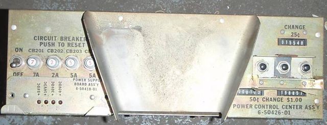

Have you never seen the test switches before on the power control center panel??? it's the 3 buttons on the right...
What about the computer control center? all kinds of fun switches to turn on and off and this and that.
plus on the computer control center, it literally tells you step by step how to troubleshoot the amount of coins being dispensed...
the ccc for the bc35 or bc12 is a bit different, but the jist of it is exactly the same.

escrow solenoid plungers probably gunked up and sticking, not fully closing fast enough.
I didn't get up there yet but from talking to them on the phone that's what it is .... Quarters are backed up in the rail.... Diverter is sticking
Lil aero kroil will fix that
I was up there and found coins backed up in the rail... The way it was set up was it was using the center bucket for $5 and the right bucket for $1...... What I believe was happening is if all 20 coins didn't stack perfect in that center bucket which is small it would not let the flapper close fully causing a backup of coins .... I reversed the 2 buckets ..: seems ok ... We will see ... Also switched the 755s to LEDs or my luck I'll be back next week for a bulb out
