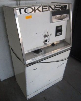

My down and dirty $40 BC-9a

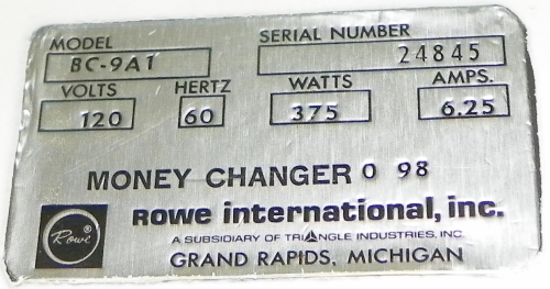

Thats strange as I have a BC-9A1 (maybe the 1 is the difference?) and it looks different...

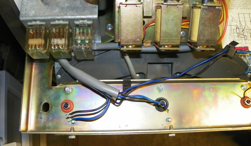

Do you have any pictures of the Hopper lights wired up?
Right now none of the Hopper lights are wired up, and I'm looking for information on how they are wired up. I figured they would be wired up similar to other models, but none of the manuals I have show how to wire them up.
The way they appear to have been wired up, doesn't make any sense to me as it would have both wires going to the casing of the lamp. I would expect one to go to the case, the other to tip of it.
