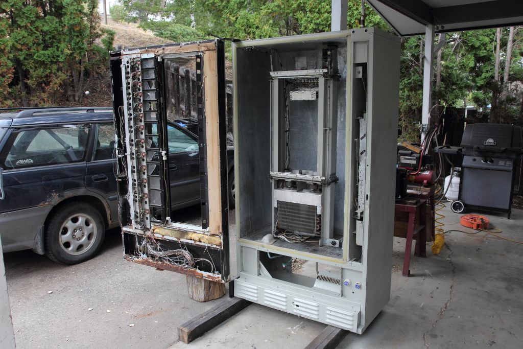

Sorry for the slightly weird first post. I never thought I'd be asking around for info on vending and arcade cabinets but then after one machine last year and an arcade machine a month ago, when this ended up in my driveway I had to find a place to get a better idea how deep this rabbit hole is. I'm not totally unskilled on this stuff but I've certainly never really messed with it.
Anyways, so this is a Rowe cold food machine that was recovered from an abandoned ski lodge. It has seen its share of vandalism but otherwise it is complete in the inside and some of the visually absent items like the coin return are undamaged. A lot of metalwork on this one....

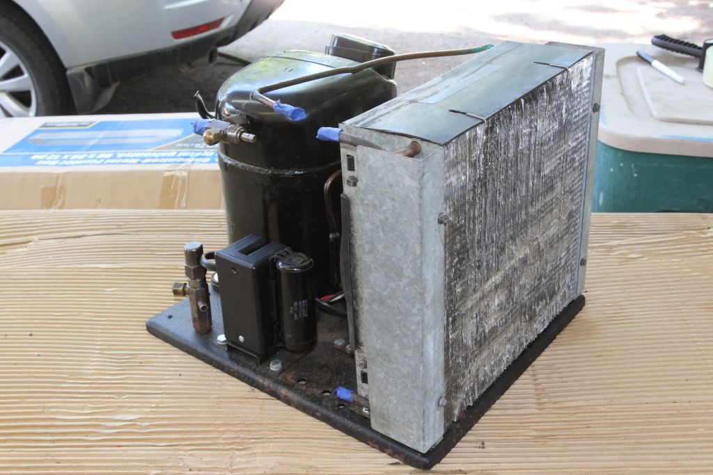

A packrat made its home around the compressor and aside from packing it full of all levels of garbage it did a good number on the wiring harness. I need schematics for the machine if I am to attempt to restore it. Unfortunately all the Rowe documentation for their cold food machines that I have found so far refers to their larger carousel machines. In fact I cannot find any information on this model at all aside from one stock photo dated from 1981.

So I am still waiting for a response from any of the above service outlets (except for Betson, who kept bouncing my emails as spam, so screw them). In the meantime when I wasn't away on business I was slowly deconstructing the bottom of the machine. Here's what we got:
-The refrigeration unit is dead. There are holes in the condenser and the compressor has seized. The evaporator and tubing threads into ports on the unit and is in excellent condition so that can be saved but this will no longer refrigerate in the meantime
-The wiring harness is in two major pieces. If I fail to find the schematics I can at least rebuild a good chunk of the system thanks to the wires being color coded but otherwise I'll have to figure out the rest on my own.
-The four adjustable feet are rusted in solid. They will have to be drilled out
-The door was removed and set aside for now
-Dismantling the base resulted in finding a massive amount of rust. Save for three pieces it has all been ground and brushed off and everything given a protective rust treatment. The remaining parts will need to be sandblasted.
-So far only four screws have broken.. I'm in disbelief how so many rusted screws are coming out
-The slug rejector is behaving after a good cleaning. The totalizer however has plastic gearing that has shrunk and broken.
-The blower fan on the door has a burned out coil. An existing splice tells me this is not the first time that motor has been replaced.

This damn machine, I swear to god, the model 147 does not exist. You can clearly see on the plate that is a 147 and yet no matter what catalog I went through and what google hit I found, there was nothing. This project got as far as I finished straightening, sanding and repainting the cabinet and rebuilt the compressor package from salvaged parts then brickwalled on the wiring diagrams because reverse engineering EM wiring sucks, wrapped it in a tarp and set the machine aside for almost five years.
Well I got pushed to figure out what to do with it or get rid of it so I sat down again and started trawling Google again and FRICK'N FINALLY I had a breakthrough.
It's indeed not a Rowe 147. It's a Rowe 447.
The bottom of the flyer dates it to the mid-70's. Capital Vending has the 447c parts and service manual in PDF for $5.
I'll verify the manual is correct, then the next action is to repair the door.

So after some extensive reading the Rowe 447 isn't entirely the same as the 147. The external trim and design is identical but on the inside there are a few changes to the wiring and configuration, such as the priceboard configuration is now a set of sliders rather than a plugboard. The evaporator is more than twice the size. Still there's more than enough that's the same between the two that paying $5 for a service and parts manual is worth it for the wiring diagrams and parts listings. It's worth noting that for all the components I recognize from my 147 the parts catalog denotes them all starting with 147. Likewise all these different or new components that seem specific to the 447 start with 447 in the part number. Other components not specific to either like switches, pilot lights and relays have some other part number. (EG: "Roll pin" 932-12, "Switch Insulator" 147-816 and "Terminal strip assembly" 447-1805)
