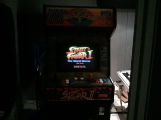

ROUND 2! Dynamo HS-2 Street Fighter II World Warrior Resto/Conv

The t-molding should be on the way soon. Going black with this one. I think I have enough purple on the machine. I did however want to get a purple coin eject button. Since I don't have a HAPP coin door, I don't think I can get a button in purple or yellow.
I also plan to make repo stickers for the dynamo, FBI warning and game lable for the back and front. Even thought of having a Aladdin's sticker on the coin door like they used to have BITD. Still plenty of work ahead, thanks for the comments.

Did that CPO include the joystick/button surrounds? Did you get the crazy bulletproof stuff or the tear resistant stuff? Did you take your monitor out of the cab to paint or just mask it off? Are games usually painted with gloss? I just got a SF2 and I want to do the same thing to mine :)
When I got my cab the first thing I did was take a look at how bad it needed to be refurbished. Depending on the condition of the cab, such as... Is it water damaged? Will it need a new panel, side wall, innards? etc etc. determined if I would go all out and take out the monitor. Some guys do since they are flipping the cabinet around to rebuild a side or two, or to put in a new bottom. Heavy work would be best to have the monitor removed.
However, since I don't have a workspace, this was all done in my 1 bedroom apartment by myself. (Wife is in Japan now, so I got away with it. :D) I had to really make do with what space and tools I had.
I've been lucky with healthy cabinets, and was able to do both restorations without taking the monitor out. Just be sure to have it over protected. I've left the old plexiglass on, with newspaper blankets and so on to mask it off. All of my nitty gritty work was on the outside of the cab, so there was no need to go through the extra step. My cab just didn't need it. It just depends on what you see fit with yours. I would then carefully do touch ups with a brush if needed around the monitor if needed with it still blocked. I used rustoleum spray paint BTW. AND PAINTERS TAPE!!
The joystick button decals did not come with the CPO. These are not the original set up of the SFII:WW kit. The decals were an idea that I took off of here:
http://www.hyperspin-fe.com/forum/showthread.php?t=3652
I thought it was the perfect idea and fit, the color of buttons and the decals. So I give credit to him for the idea of the CP. Also it seems as if he took the same approach of prepping the cab for painting like I did, so it does work if you're careful. Now, if you want to restore your SFII with the original generic kit set up. Don't use the decals, and use red,white and blue buttons. (In that order)
From http://www.gameongrafix.com/products/street-fighter-2-cpo I used their defaulted material. Polycarbinate laminate (also used for bullet proof glass!) which offers a very tough, scratch resistant and textured surfaces.
(get the adhesive backed CPO!) It's really great quality.
