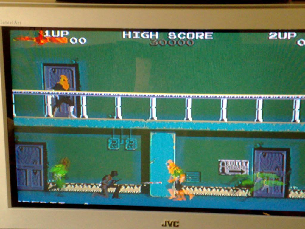

I just bought a Rolling Thunder board, a Jamma and the collors are wrong.
Looks a lot like red is missing, anyone know why?
It's a board problem for sure as it's the same in any jamma cab and on my Supergun.
I contacted the seller but I really don't want to return this board as I love the game.
Any help greatly apreciated.

Check video harness. Use slight tension/wiggle by the monitor and by harness and see if colors or sync changes. If so, you got your answer :)

Had one of these in the shop that only output blue colors.
Replaced bad 82S147 PROM at 3R to fix it. The PROM at 3R outputs the red and green. The PROM at 3S outputs the blue.
Luckily the dumped ROMs for MAME had the PROM image in it.
