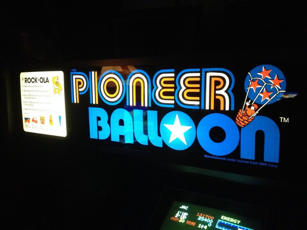

Some actual screenshots of my game:
Sorry about the massive curl on the right side. It seems this, Nibbler and Jump Bug are pretty finicky when it comes to their video output and all have different sweet spots. I adjust the monitor perfectly for one of them, then I pop in a different board and the image is all out of whack again.

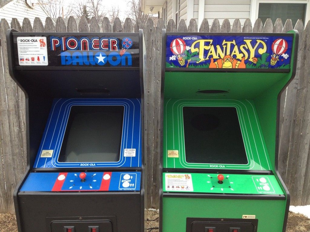

think that is the first time I've seen either of those titles in full cabinet with sideart and marquee form.
Great work!
