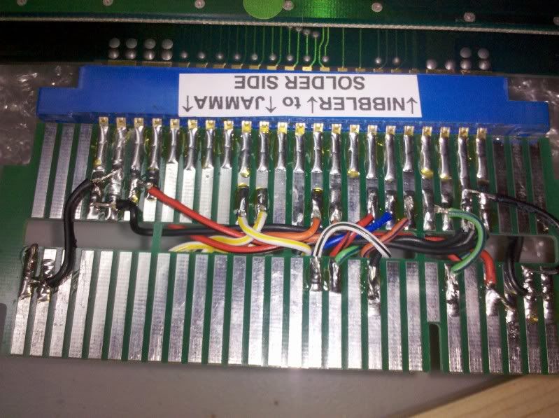

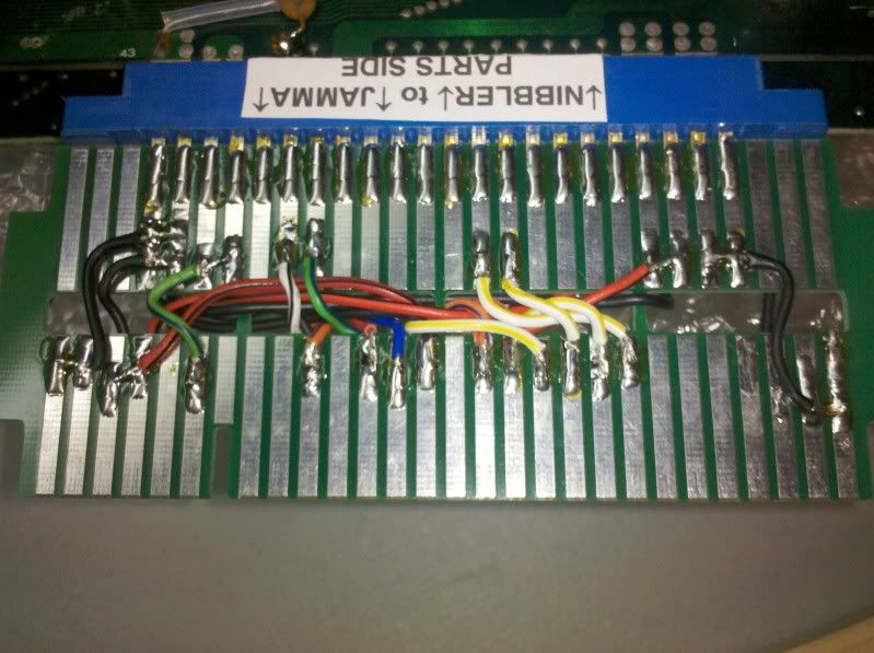

Picked up a Nibbler board that was stated as "working"
I have a cabinet that is wired for Jamma.
--using Nibbler to Jamma adapter from Mike's arcade
--using a CGA 2VGA card
--Dell 19inch LCD
--switching PS for typical 12v, +5, and -5.
--works fine for real pcbs of Moon Patrol and Tutankham with Bob Roberts Jamma adapters so I know it's a good setup.
When turned on, the monitor says "No signal" for awhile, then I can hear some high frequency buzzing, then the nibbler screen appears for a second/grainy, it rolls vertically once then disappears. rinse and repeat.
I've tried various cga/vga card resolutions, same behavior.
Anyone ever tried a Rockola to Jamma setup or have some hints to pursue. Is there something unique about the video output for Rockola setups?
I have a real CGA monitor in an arkanoid cab. I suppose I could rig up the jamma harness to temporarily use that monitor as a test. if I have to, but I'd rather not.
Thanks in advance.

The way this appears to me, that video is off, then it comes on for a second and rolls, makes me very suspicious of the video output from the board itself.
I got it from Quarterarcade so I'm sure he'll replace it if it's defective.
tried the board in a nibbler machine with jamma adapter.
Works properly. whew.
so the sync signals off the nibbler boards must be slightly out of the range that a cga/vga converter card can handle.
going to put a small cga monitor in the cab and roll with it.
I did learn that the Mike's arcade Nibbler adapter is missing the wiring to start a 2player game. Gotta add the wiring on the adapter itself.
also learned that this board is v9, where the dots get regenerated when you die on a maze. they marathon v6 because the dots don't regenerate so you can point press the timer when dying.
Thanks for the help everyone!
