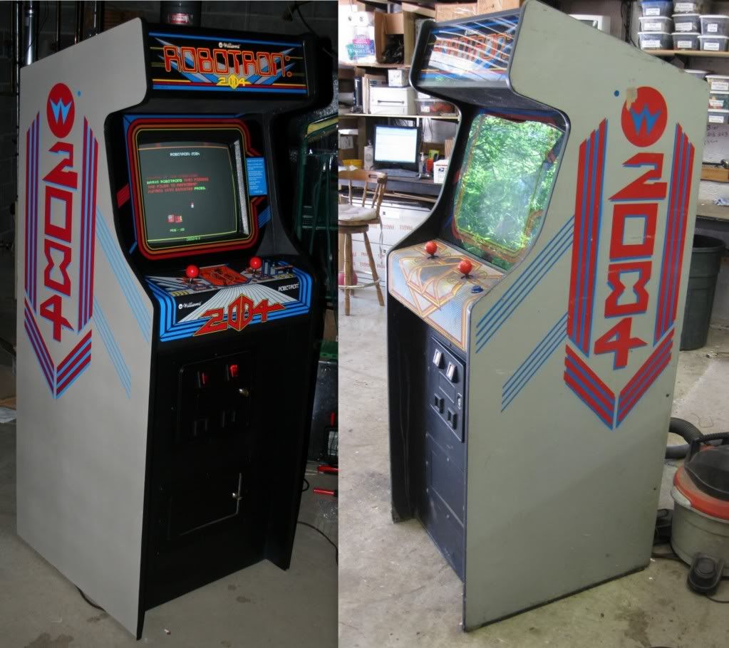

Picked up a non-working Robotron earlier this Summer. Here is what she looked like:
The ugly Willis control panel has got to go
No top back door on the cab
Bezel has some flaking and no instruction sticker
Cigarette burns everywhere and both joystick balls are pretty banged up. .
Worst part of the cab is the front corner. A good healthy application of bondo will take care of it.
That looks great!
Is the upper back door and top in need of painting or is that just the lighting in the picture?
Comparison shot of before and after
The angle of this shot an the lighting make the red look darker than it is. Refer back to the outdoor shots for the true color

What silver did you use? I always hear a lot of people use the "Can't find the right sheen" excuse to never restore their Robotrons or Sinistars.
The codes listed on pRok's site are right on. It's a two step process that requires a base coat and then a metallic top coat. Looks really good in person.
And a special thank you to member Joeycuda for some advice and tips on the painting process.
