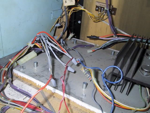

Well, for this second, my two main goals are properly grounding the new switching PS, and fixing the sound... it still comes out so soft, even with the new PS...also, the lights are out on the CP...I have no clue why.
You need to run the +12V to the sound board. The lights can be run from the -5V. They will be dim and you will need to make sure that the return from the lights goes to the DC ground (the one marked GND).
Alternatively, if you have the original transformer in the cabinet, post a picture of it and a closeup of the connector going to the power supply board and either Dockert or I can get you the correct linear power supply and take part of the problems.
Normally if someone really wants to use a switcher in a Williams game, I recommend that they use it in parallel with the original linear PS. Use the linear to power the coin door and general illumination (6.3VAC) and wire the switcher to supply board power.

Your lights are not going to work until the connector that is hanging free in this pic is connected up. The one that goes to the big power resistor with all of the yellow wires.
